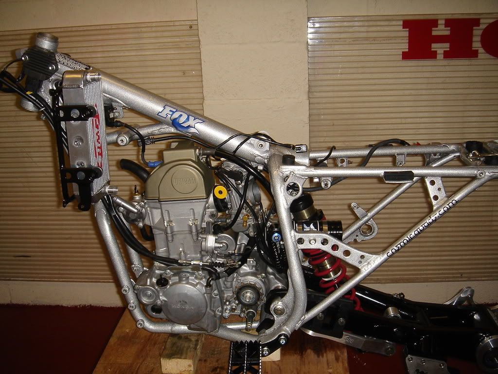

    HONDA HRC 450RR

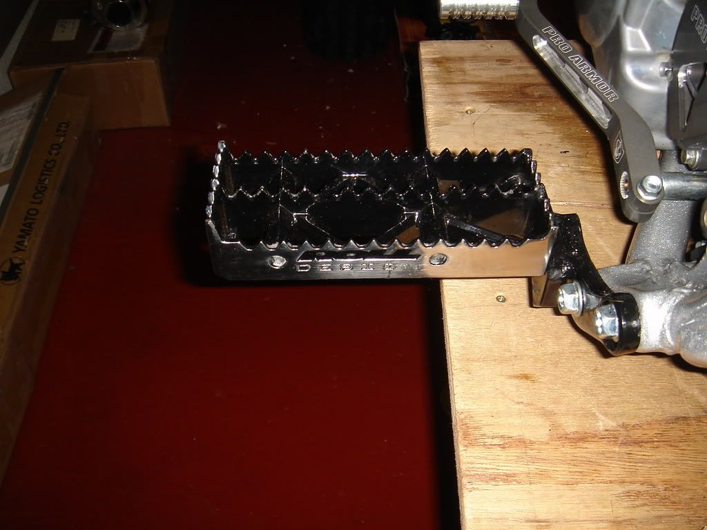

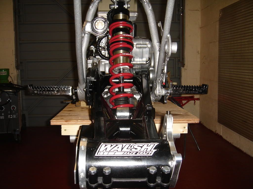

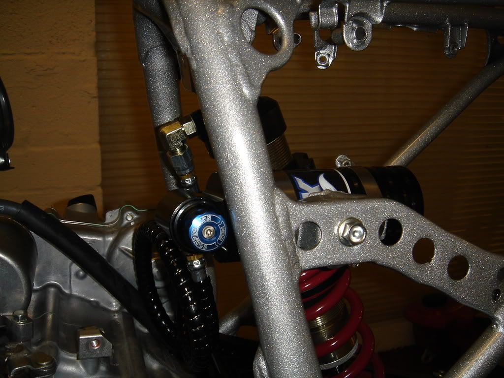

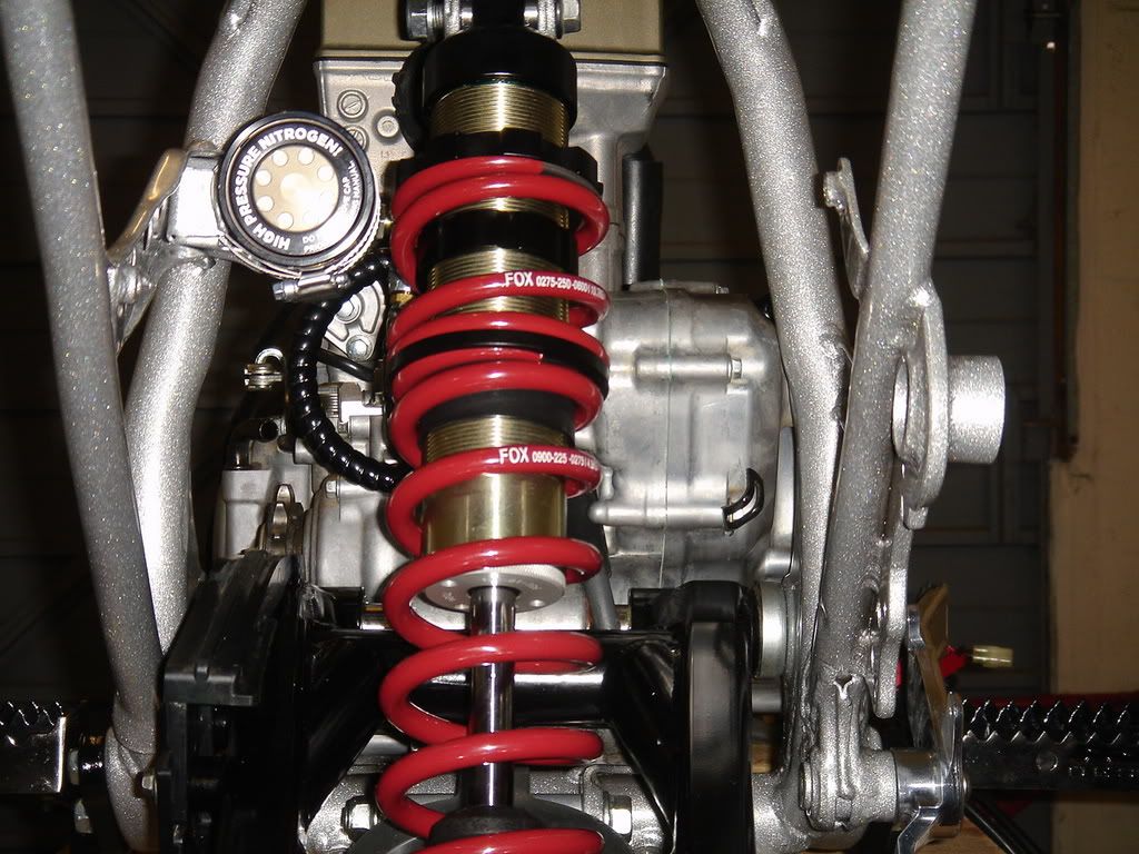

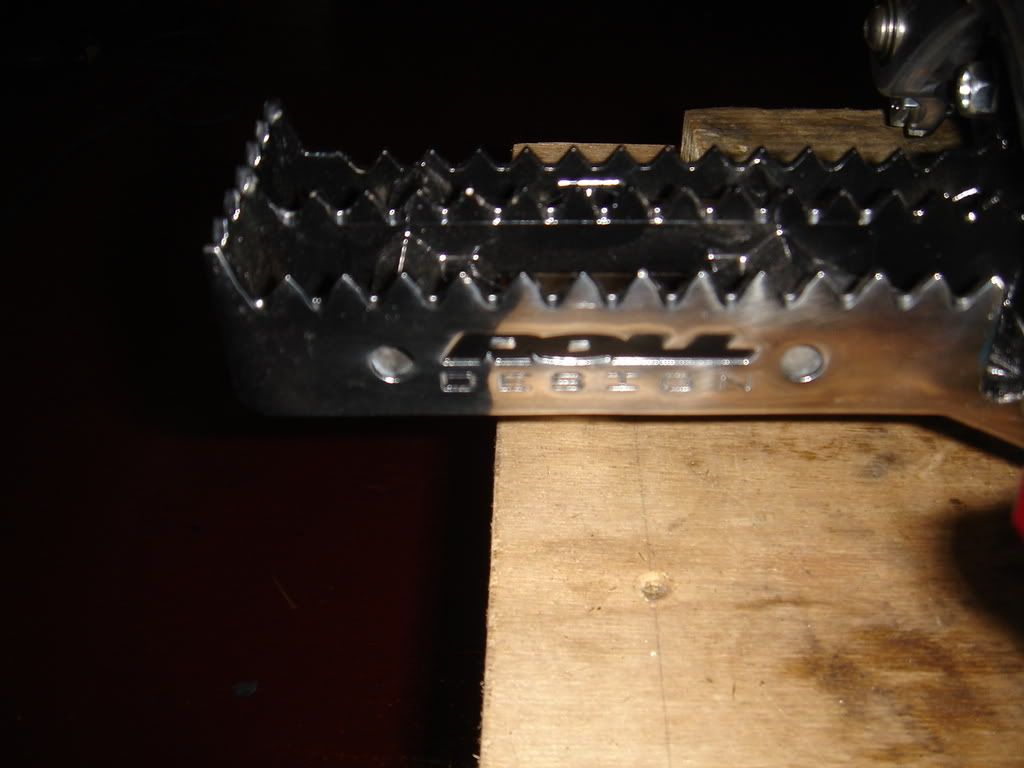

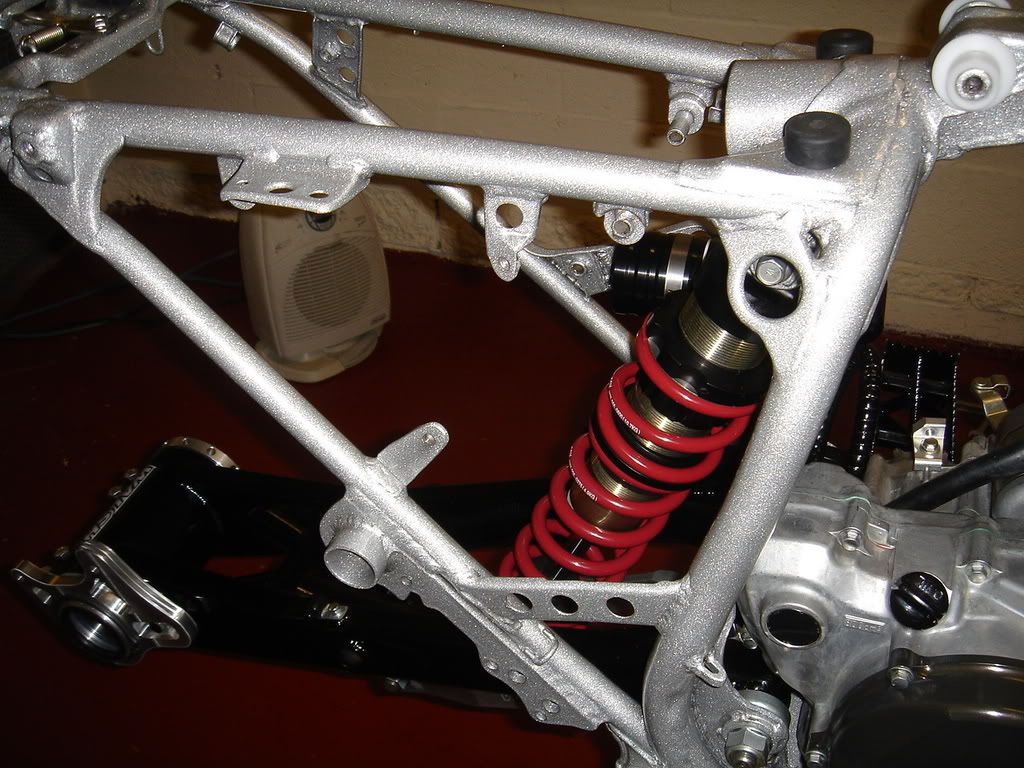

    Right, mmmm, whats next?,,,ah yes, the rear Shock....
    WALSH RACE CRAFT 'SAVIOR' SPECIFIC - FOX PODIUM X REAR SHOCK 17.875" Long.
    Also pictured are the IMS ROLL DESIGN Pro Series footpegs, these had to be modified slightly, the mounting brackets for the pegs and the OEM plates were removed and the pegs TIG welded onto the 85 OEM plates.
    Next - the CARB + RADIATORS!!!!

    HONDA HRC 450RR

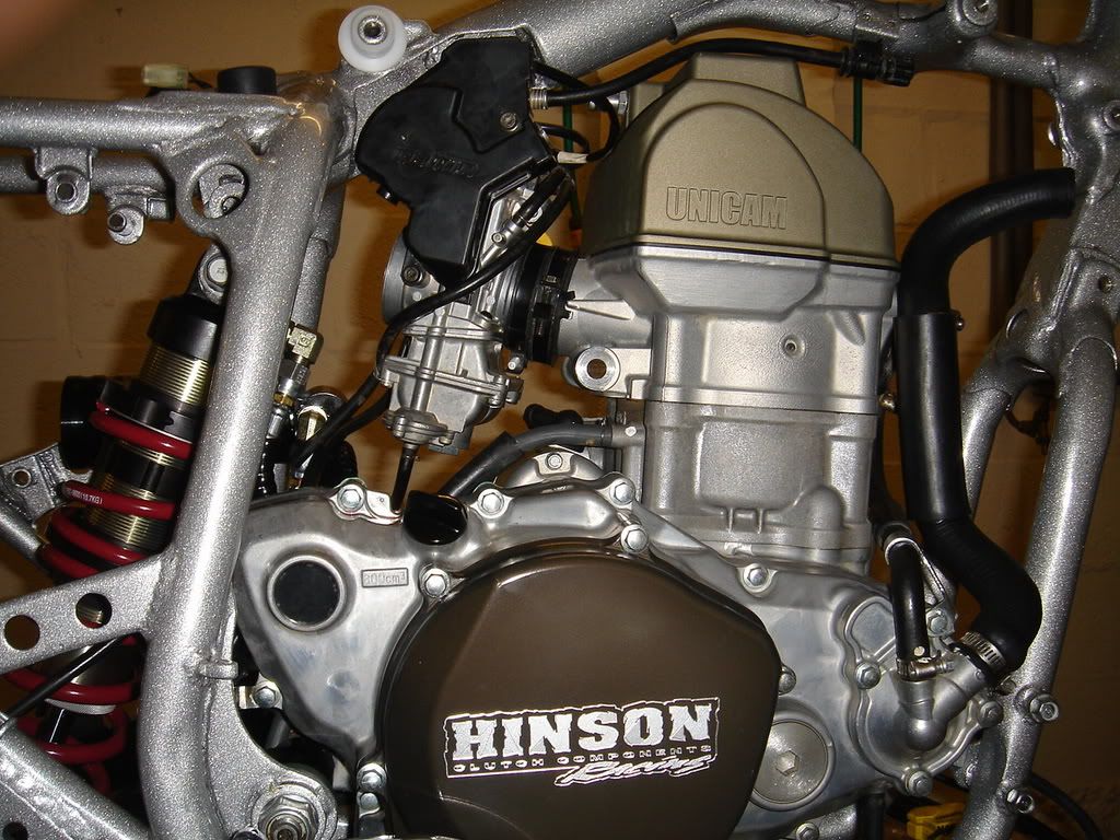

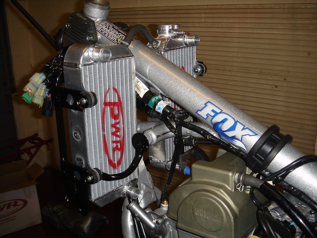

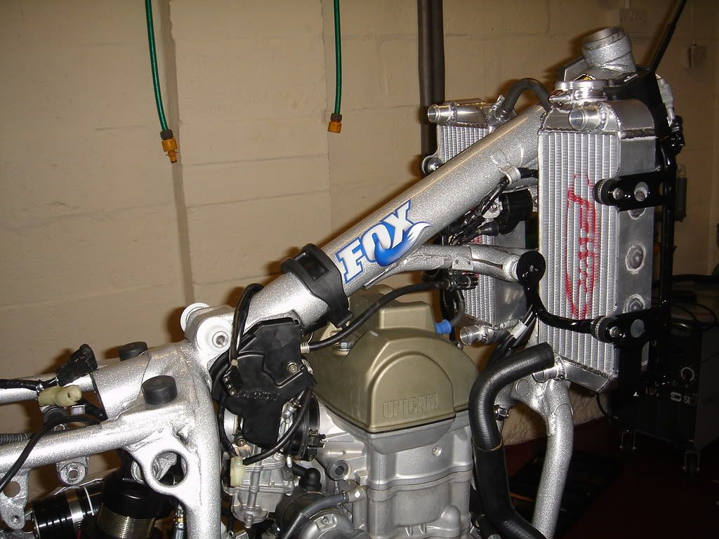

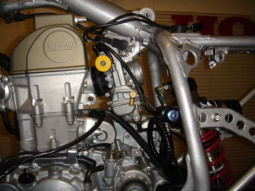

    Okay here's some pics of the carb, coil, rectifier, & ECU, all mounted.
    now the radiators!

  9. #114
    Nov 2006
    southern oregon
    2,338
    Do you plan to use an upper engine mount? I don't see provisions for one...

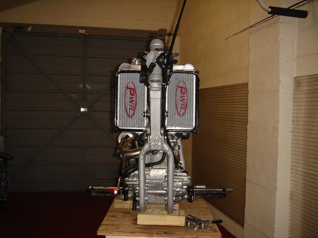

    HONDA HRC 450RR
    Here we go - PWR large capacity Radiators,

    Hrc 450rr
    Quote Originally Posted by cr480r View Post
    No, no upper engine mount,,,,if i think its detrimentle to the the bike, i'll add one latter. At the moment am happy to run without it.

  13. #118
    Frewsburg NY
    1,169
    This by far is the nicest R build I have ever seen on the boards. Your attention to detail is amazing. What kind of $$$$ do you think you will have into this build when done. (rough idea)

    Quote Originally Posted by johnny's X View Post
    Crikey,,,,good question,,,Mmmmmm,,,,let me check the wifes not looking at me typing,,,,,okay shes busy ironing!,, I'm really not sure, the TRX 450 cost me $8000.00, i could sell the rolling chassis if i wanted to recoup some money, then i guess
    triples = $2200.00
    front shocks = $1600.00
    swinger/shock = $2195.00
    axle/anti fade, = $1000.00
    misc = $3000.00
    So probably somewhere around $18000.00, and thats without putting a single $ on my time,
    Thanks for the compliment, am glad you like the build so far.
    * I COULD HAVE BUILT THIS BIKE USING AS MUCH OF THE OEM TRX 450 PARTS AS POSSIBLE - THAT WOULD HAVE REDUCED THE TOTAL BUILD COST CONSIDERABLY*
    But at the end of the day i have tried to build a trike using the newest / state of the art parts as possible Unfortunately Technology costs money.
