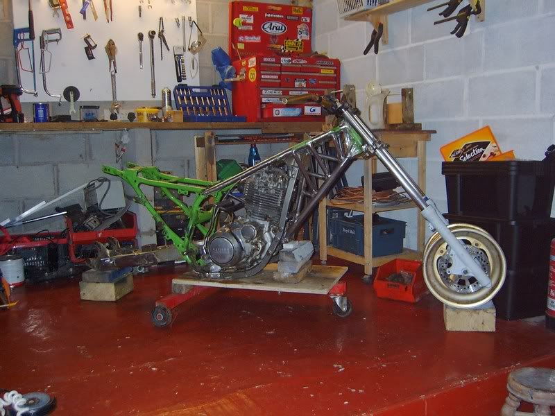

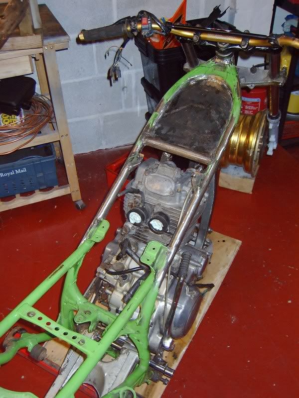

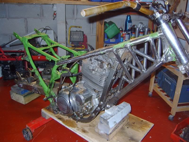

    Love it or hate it here it is as its going on the street long & low was the only to go theres plenty more fabricating to do including stretching the false tank which i'll probably make out of stainless sheet & its gonna be the hardest job - i want it the exact same shape as the original only longer. Although its radical when its finished you'll still be able to see thats its a Zee with a twist which is important to the final look. The grafted in cradle unbolts so I could push the lump in nice & tight. I'd appreciate your comments including the bad ones & thanks to the guys who are helping out by shipping parts for me - i'll keep updating you as i go along

    What are you planning on using it for? I would think that trail riding could be tuff with all that rake.

    did u stretch the frame on that or is it still the same lenght

    its purely for the street hence the 2" rake, i've stretched the frame by 6" aswell. all the body panels will be Zee so the original seat needs to tie into the tank & look original. Trust me it will look sweet when finished

    I love it, especially that ladder design bracing in the backbone going up to the steering neck. Should be bad ass when its done.

    what is the engine out of

    the part under the tank looks like those old bell helicopters looks good so far

    nice to know you guys like it, i'm staying faithful to the Tri-Z as best i can which should show later in the build. The engine is out of an SRX6 which is the same as the XT600e without the electric boot, the twin carbs fit with no probs so i'm now onto the next job looking for something to convert into an oil resevoir & battery holder. Its time to start raiding friends garages for suitable donors

    I'm collecting bearings & stuff at the moment ready for the first dry build, the remote oil tank is nearly finished & i've rebuilt the forks. I'll need a shorter rear damper to lower the back end so a day rooting around at the breakers is on the cards soon
