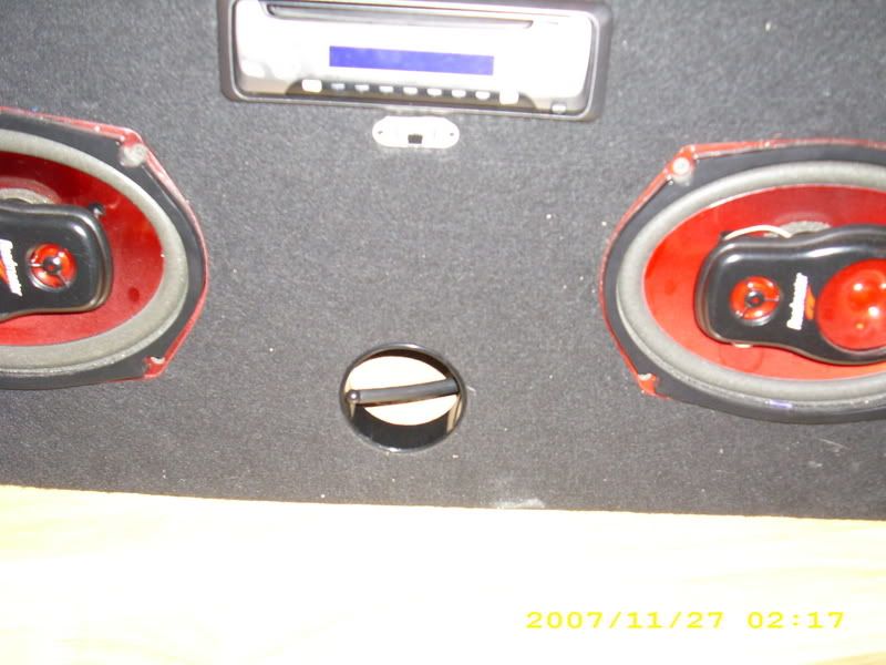

    different HDD power plug will NOT help.......all those wires lead to 1 terminal in the power supply. i know, i use Computer power supplies to power car stereo equipment in my house. i made this nifty speaker box that plugs into the wall, and it uses 4 6x9 speakers, a car head unit, and a amplified EQ mounted in the box.
    the box
    the lil switch below the head unit is for switching power options.
    and the radio antenna is in that port hole. use it for the drive ins!
    the power options: plug it in or clamp to car battery!
    the switch is so the clamps are not powered when its plugged in, so it wont all short out.
    the extra plugs on the back were to hook up another amp. the terminal cup is power, and the RCAs are signals.
    but the RCA's on the head unit are fried. i revived the unit from the dead by putting a new amplifier chip into it (previos owner wired it wrong)
    the rca's still didnt work, but i didnt find that out till i tried to use it all.
    noise supressors are used to keep the buzzing out of the speakers that is generated by the power supplies.
