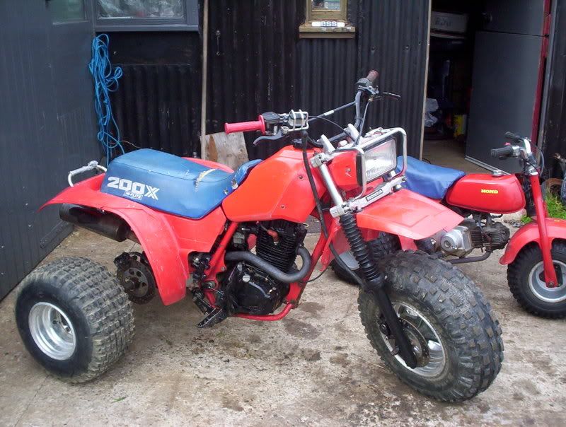

    a engine out of a 185 or a 200s atc will fit in the 200x frame the 185 200s dose not have a clutch sem auto , so the 200x becomes a 200 autox , wireing is a little difrant but a easy swap , hears my autox
    you can see the pull start on the 200s engine (motor)

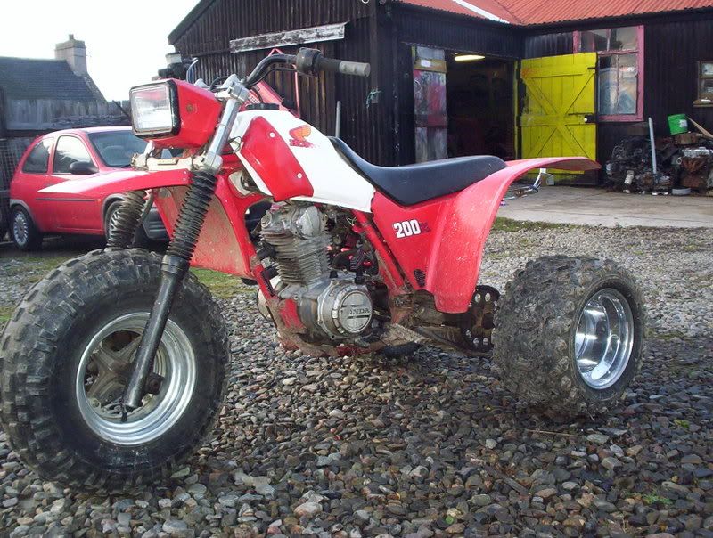

    a pic of my other 200x this trike came from the states about 4 years ago it has a plastic tank , wheel spacers, 18s rear , and a nice seat
