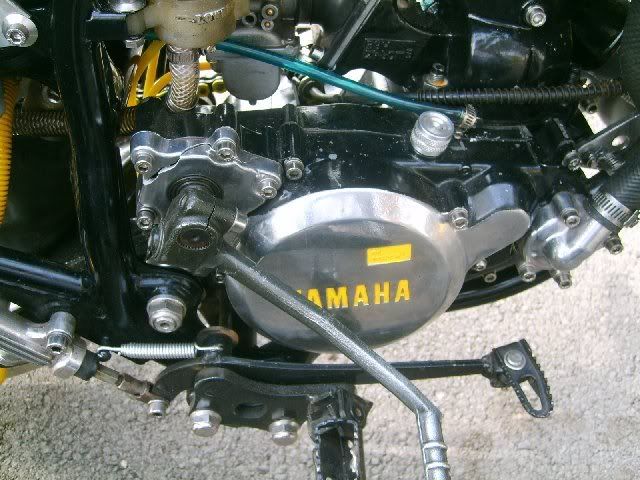

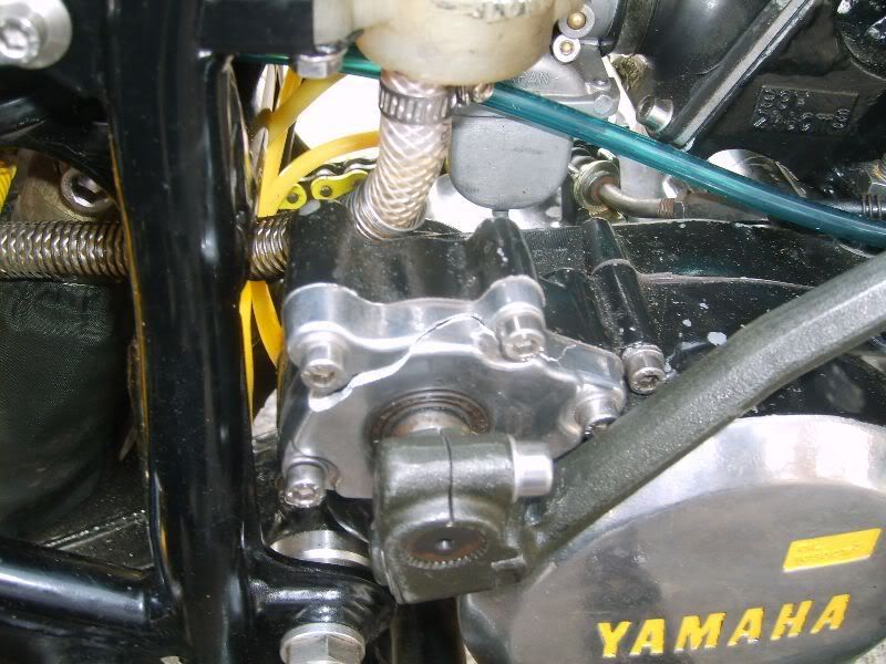

    I've seen some pics of the entire clutch cover cracked in half already... What you can't really see in these pics is the crack in the cover behind the kicker cover.

    I never took a picture of mine when it cracked. So I will use Chris's pic to show what happened.
    In the red is round about where mine cracked. It didnt hurt the kick cover, just the clutch cover itself. It split about half way down.
    After that I have taken Moshes advice to heart. Park on hills, and to go a little further then that, I have my bike pull started if it doesent start on the 2nd kick. I aint riskin that sht again!!!!!

    Mine was the exact same as ATC Erics, and my photo is damn near the same

    Thanks for the pics and info guys. It looks as nasty as it sounded!
    I'll have to be x careful I guess.

    Thanks chris... I have never had the kicker cover crack.. the clutch cover cracked like the red line one .. and that was because all the bolts were loose.. the one I need fixed has a crack across the back side..behind the gear
