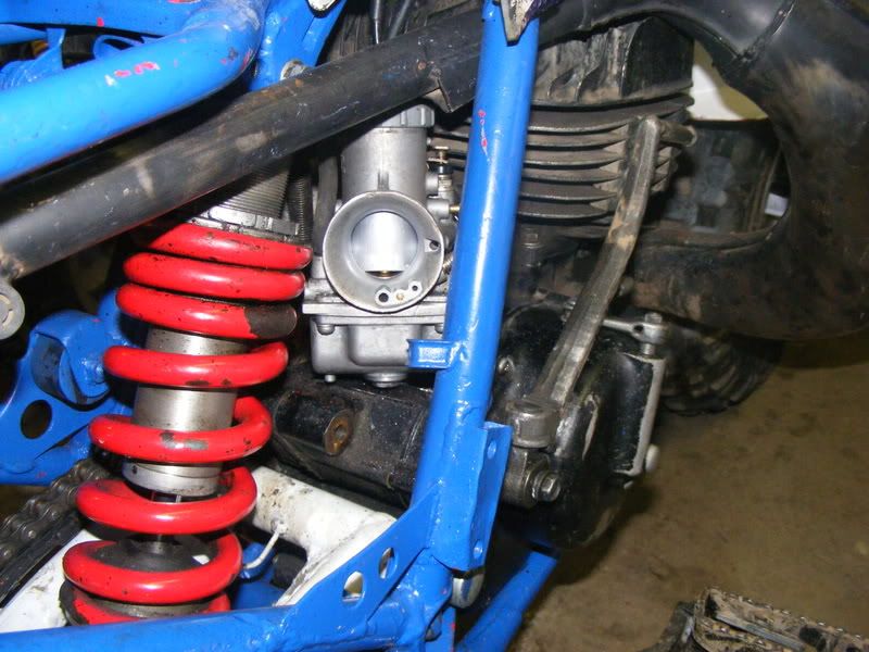

    Heres a pic of the area. Couldn't find the stupid tape measure but I'd say theres around an inch at the top and 2.5-3"s at the bottom.
    Wondering if it would be better to make the foam flat, or wider at the bottom.

    Hey bud, we all love your conversion. But, you can't mess around with a filter. It HAS to be adequate. This isn't a half arse built go-cart. Let me ask ya this, if you could change the intake angle at the motor, could another angle squeeze in a place for a radiator hose that adapts to a K+N filter or something.
    Give us a back shot of this too!! In other words, a pic of the shock interfering...

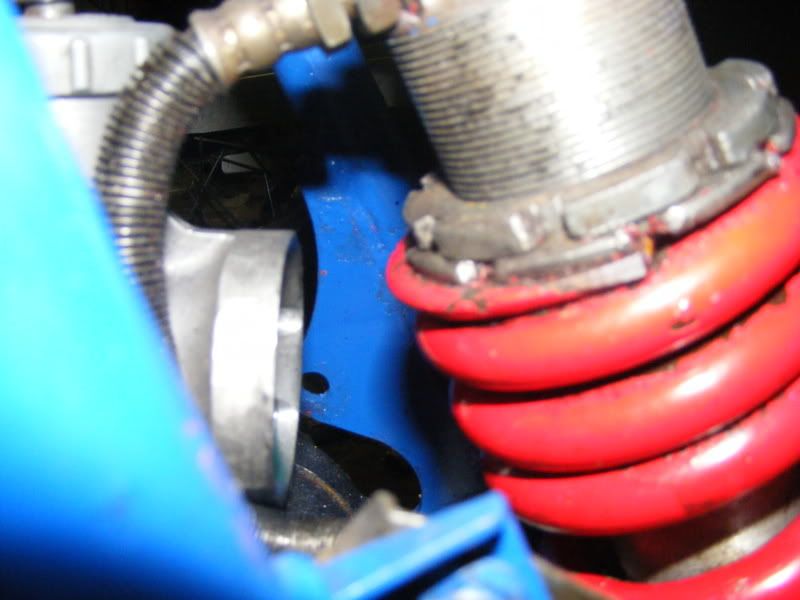

    I'm not quite sure I understand what you mean about a pic of the shock interfering?
    Sorry.. I haven't really woken up yet.
    You want a pic from the back, or.. from an angle?

    If you look from the back, I'm guessing that it's the shock spring that your running into. If the carb could be angled a bit more to the left, is there room for a hose or something??
    Sep 2007
    British Columbia, Canada
    818
    Yes it was the shock that I was running into.

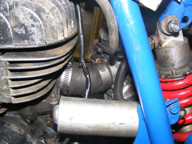

    I found a rad hose that had a nice bend it in, cut it and this what I came out with.
    Still seemed to run okay, but I didn't ride it, just started it and let idle.
    There's just enough room to run a hose now. I'm hoping to find one that'll fit the carb, and run a K&N that I have here.

    What i would do is find a real hard bend for a carb boot, what you have there looks better than before. You might be able to squeeze a filter in there thats very long and skinny. Like a long ass KN or something?
