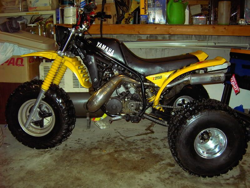

    As per Raffa's reccomendations, I think I'm going to get a Dunlop KT646M tire for the front of my tri-z. I think I've setled on the fast trekkers for the rear, ut not sure if I want 20" or 22"... I know the tread design for the 22 is slightly different but it still looks really sharp. Anyways, do you guys have pics of 20" tires on your tri-z? Trying to get an idea of what they might look like. I don't mind the 22s, but what are any of the benefits to going to a smaller tire? If I went smaller I would re gear to compensate. But I don't want to give up alot of ground clearance either. but pics would help greatly

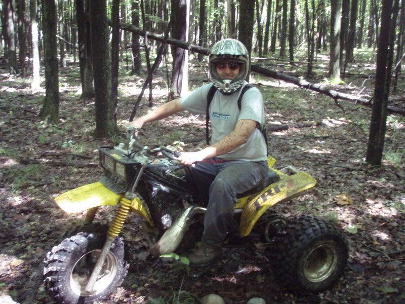

    heres 20's on the black bike and 22 on the red.. hope that helps ya

    22's are huge... 20's are a great compromise...

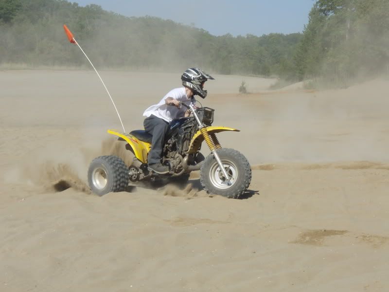

    yea i got 20's on my tri-z they seem to be just the right hieght and look

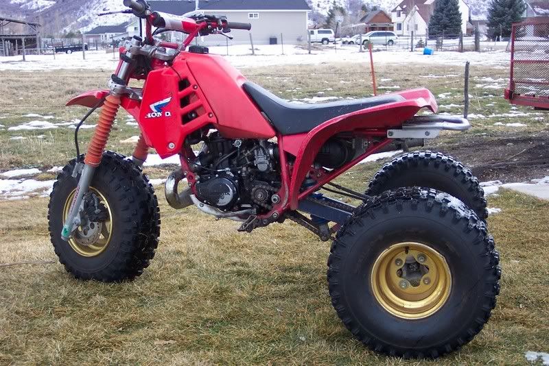

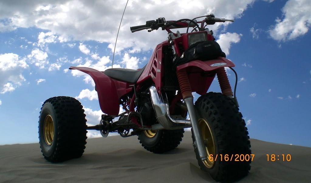

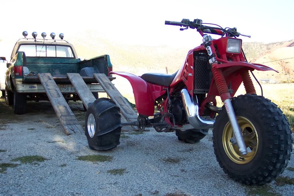

    I like the 22's on my R. I am light enough and the bike runs well enough that it can handle the 22's with stock gearing, and then I get that little extra speed without really loosing much torque.
    However, on my truck, if I go with a tire size just a couple inches bigger, I can really feel the difference and loss in power. So overall I think it depends on the weight and the bike. In addition, not all tires measure up to be the size that is printed on them. My 25" tires are only about 22" or 23" tall, and my 11" wide tires measure up to only be 10". And yes they are properly inflated or uninflated.
    Here are a couple pics. Some of them are old ones. It is hard to compare, becuase one is a paddle and one is a knobby. Paddles are 20x11-8 and knobbys are 22x12-9.

    thanks for the input guys From certain angles, the 22's look huge while other angles the look pretty good. I just wanted to see what the 20's looked like, didn't want anything that looked too small. Never had any problems stability-wise but I never go overboard with my riding.
    Just wondering what effect it will have with the low end vs. the top end speeds. Sure I can re-gear too. But it might help with some of my riding in the fields around here, seems to bog down when I get into fifth gear and sometimes fourth, but the carb needs a little tuning too.
    But the 20's will be a little more suited for a performance oriented machine, correct? Any advantages I will see besides looks and stability?

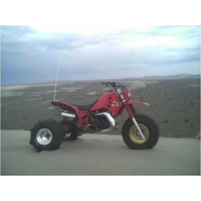

    I have 20x10x10 Fast trekkers on my 250R and i love them
    Here is a picture
    Hope this helps
    OH and go with the 10x8 wheels if you go the 10's, it will put the sidewall out a bit more better protecting your wheel.
