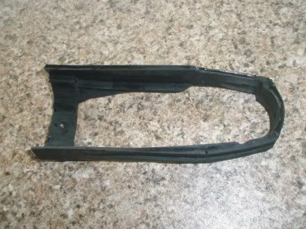

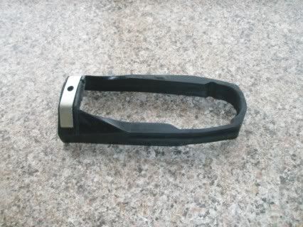

    Finally some made
    I have finally been successful in the reproduction of the '83 - '84 chain slider, it is made from black castable erapol.
    They are not 100% perfect as the one I used for the mould was not perfect but they are reasonable for the price. (If I could get a N.O.S one they would then be perfect)
    As I don't wish to handle posting etc I have made them available from Ric at ATC Heaven
    http://www.atcheaven.com/ATC250r.php...ws_ATC250R=199
    Here is a couple of pics I took
    There is one on ebay at the moment for sale secondhand and the bidding is currently at $126 It finally sold for $202.50
    I would have loved to been able to afford it to take a mould from it.
