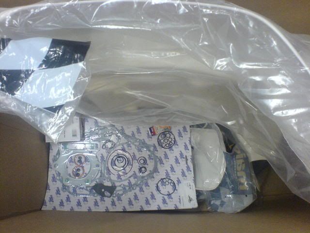

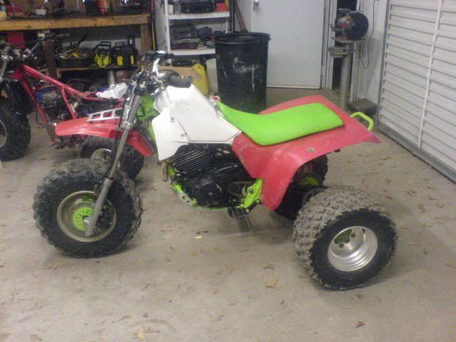

    So here is what I bought
    And ten minutes after I picked up the the bike I was on the phone ordering parts so they would be here ASAP. They didn't arrive on Monday like I wished, but they are here now.

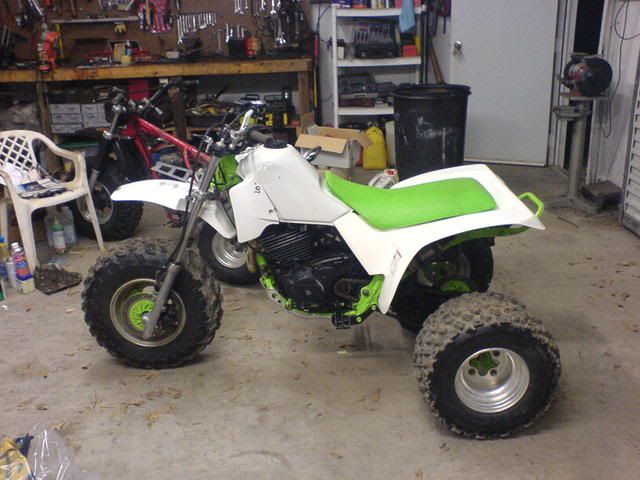

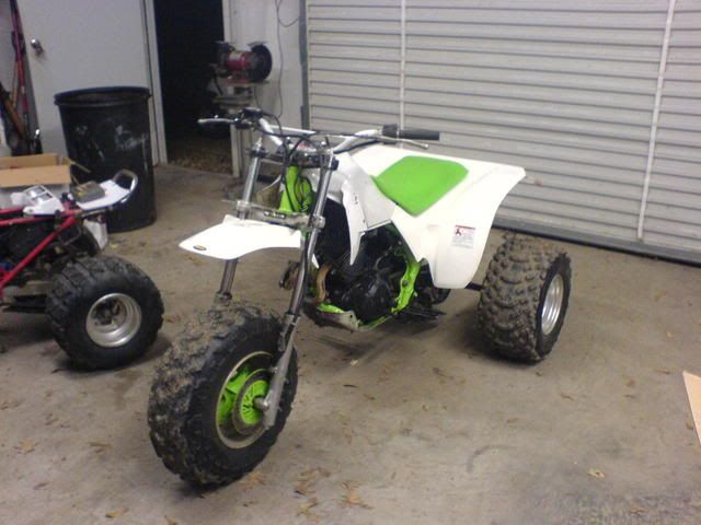

    Here is what it looks like now.
    The bike won't be this complete again for at least a month or two. Probably going to go all out with this one.

    wow! new plastic set it off! just like I thought it would! should be a looker when its done!

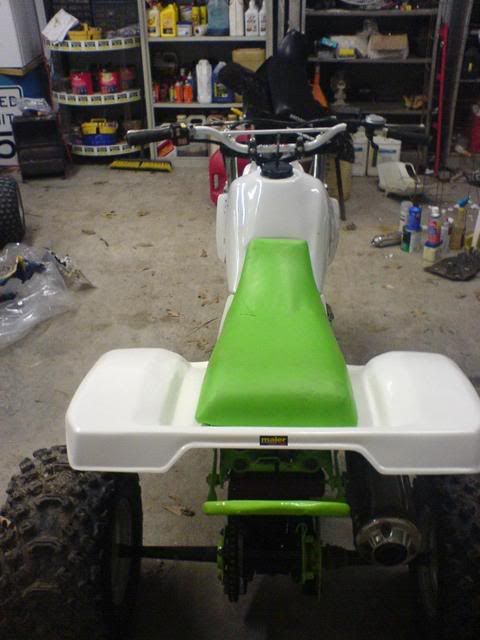

    thats cool it dont even look like you moved it from the first picture..lookin good
    whats the matter.. just cant bring yourself to drill holes in that new front fender?
    is that what that ugly silver thing is for? To be honest I wasn't sure. lol. I just couldn't understand why you would need one.

    awww man....you dont like the fender brace??? poo on you homie!

    and syko, it's hondaline...not my thing, i prefer clean, uncluttered, nothing on the bike that isn't needed. besides...you forget one important thing.... I don't drive like you man, compared to how you can ride, this thing is gonna be babied, my fender will never go down that far. lol.
