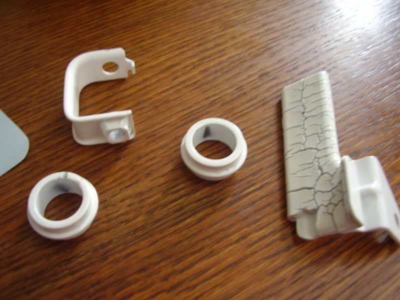

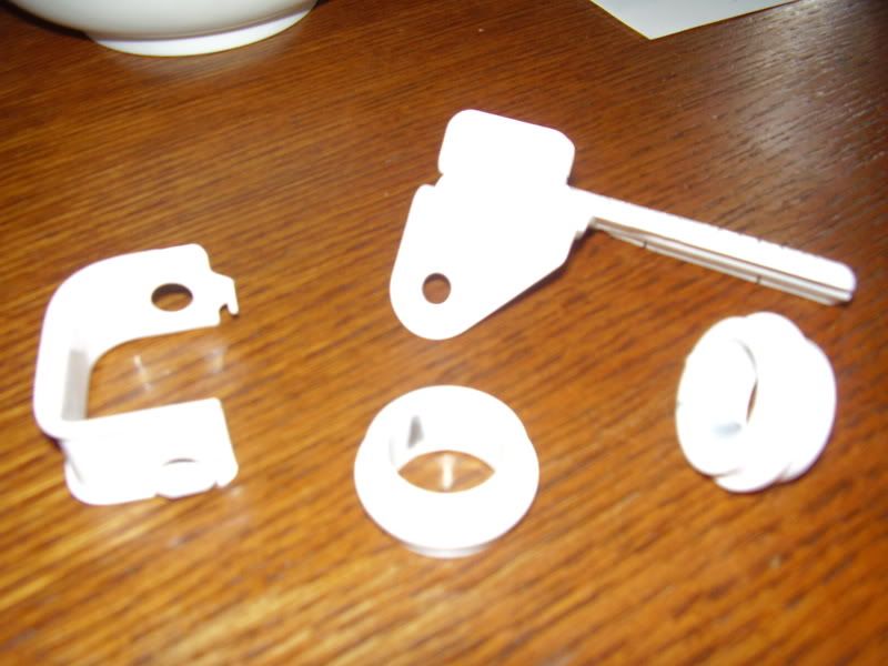

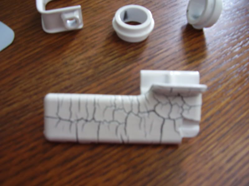

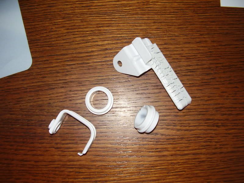

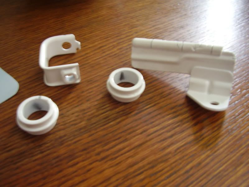

    hey guys,
    Powdercoater didnt put parts back in the bags so theres these last ones I cant Identify.
    Anyhelp?
    Theres the 2 small round peices
    C shaped threaded one
    and the L peice???
    Thanks alot!

    the C shaped is a Roller Bearing Holder ....

    Okay,
    The 2 small round pieces are the swingarm bushes - they go either side of the needle bearings, you should have 4 of them - you dont need them pc,d.
    The L piece is the upper chain slider, it bolts onto the outside of the frame, where your rear shock ressie is - the bolt goes through the slider then through the frame then through the ressie holder (detachable on the 86 model).
    The C shaped piece is the upper chain roller also( should have a roller to go inside)goes to the right side of the ressie bracket,
    Hope this helps.

    The flat metal and plastic peice is a chain gaurd.The o shaped things go on the swingarm bolt.

    Oh thanks alot guys!
    I got Xsystem bushings so I shouldnt need them O shaped things?
    Thanks alot guys, it all makes sense now!
    Nope, and im almost 100% sure that if you buy new all-balls bearings they come with those "O-shaped Things"

    you guys sure those 2 round deals aren't the hard plastic bushings that go on the frame to guide the seat latch assembly?
    edog's Avatar
    Mar 2004
    New Hampshire
    6,629
    Quote Originally Posted by Derrick Adams View Post
    Very shure......
