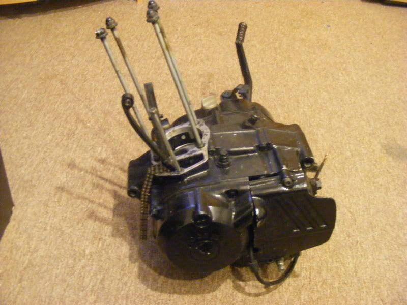

    How do you guys ship a bottom end?
    Seems like I'd need a pretty big box to fit over the studs sticking out, and even then, I'd be worried about them getting bent or breaking during shipping.
    A lotta styrofoam, and padding?

    Make a wooden crate for it. If your worried about the studs getting bent I would put a block of wood between all 4 so they cannot bend inward or snap.

    A wooden crate would weigh an awful lot. I always ship engines in a heavy duty rubber made tote. Go to Lowes and they should have what I'm talking about. DON"T USE STERILITE brand totes. They're brittle and won't hold up. The rubber made ones are nearly indestructible.
    Drill holes around the edges and run zip ties through the holes, sinch em down tight. WALLA! Instant engine crate (don't forget to pack the empty space with newspaper)
    Take it to UPS and they'll slap the label on the lid and send it on its way.

    hey, take the studs and kicker off.

    Thanks for the idea's guys. 4cylinders, how do you remove the studs?

    Couple different ways to do it. There's a tool to do it, also you can back two nuts against each other and use a wrench. Kinda risky sometimes. You can mess up the threads in the cases, twist the studs. etc etc.
    If they don't come out easy then stop and try some heat. Just don't force it.

    Oh okay, I was under the impression that they were pressed in for some reason.
    I'll try that, thanks.

    Well I got them out, fairly easily too. Thanks a lot for the help.
    The only thing left now is the timing chain guide.

    Storm Impulse shipped me a 200x bottom end before xmas. He just suff in newspapers and it turned out fine. A carboard box taped all around.

    I got my new motor shipped in a cooler! worked real good.

    stiff styrafoam would have been fine- just lable it as up,and down, and fragile-
