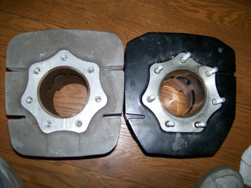

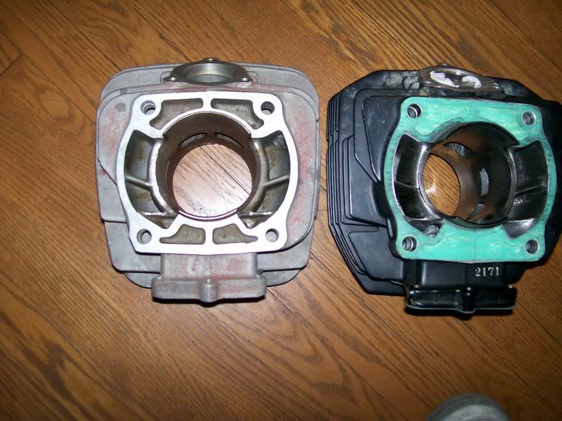

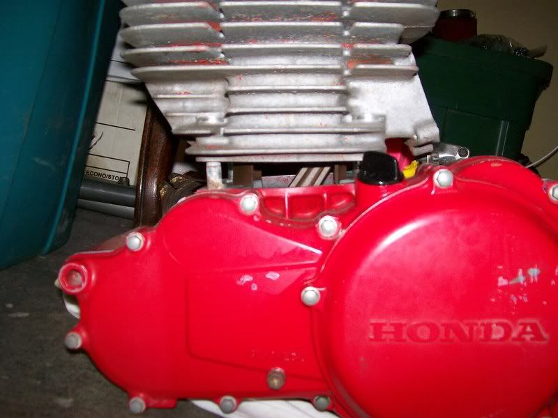

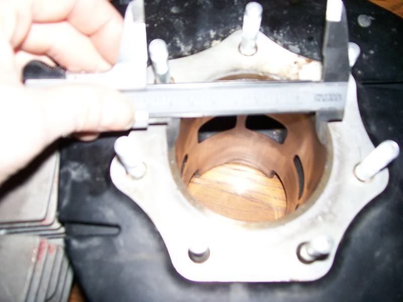

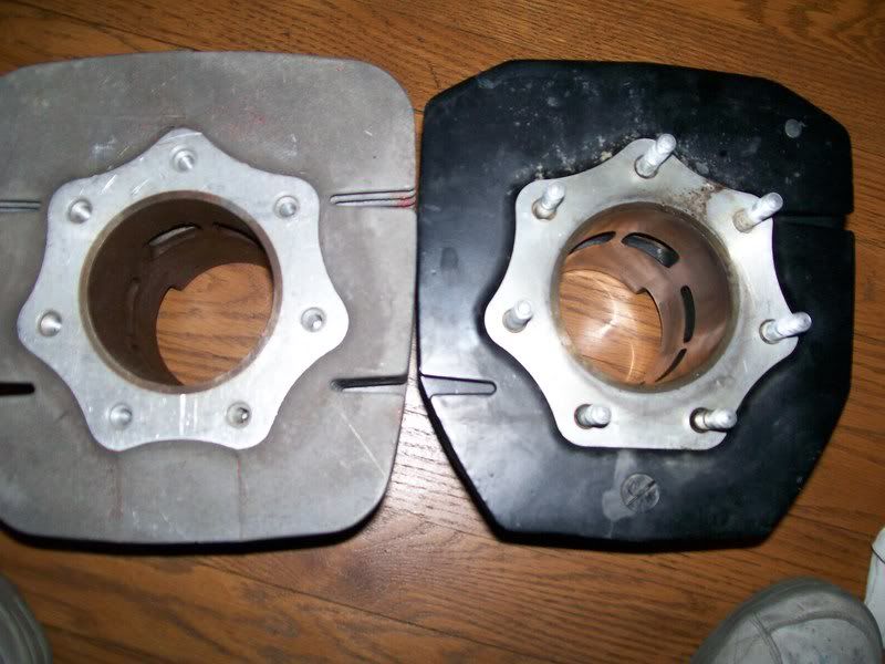

    What I thought was a 300r kit arrived today and I was comparing it to another practically new one, well I not only discovered that the cyl was NOS like the seller said but also was 80mm and shaped slightly different than the 300 also it doesn't fit all the way down on a bottom end I have down in the basement, I measured how thick the sleeve was and compared it to the new 300r kit its the same but the bore is 4mm's bigger and 2mm's bigger than the FL350 cyl I have I think it's a mugen for the 81-82 250r
    The only thing that sucks is someone bead blasted most of the tomato red paint off.
    Heres some pick's.

    More pic's

    The only problem is the dg head is for the stock 6 stud cylinder but this and the hondaline 300 kit have 7 stud cylinders.

    That head could be reworked to fit. I bet that cylinder would work great with the cases bored.
    Apr 2007
    774
    Yep but it doesn't have the same contour on the fins also it's obvious the cases will need bored i just set it on the motor to show how large the sleeve is.

    After checking this cylinder out it is clear that it has never been used. It is also not the same bore size that the mugen 360 is advertised as being. This one is 80 mm. Also the pictures that I have seen of the mugens show them having 6 head studs not seven. The nice thing about this cylinder is that the fl 350 pistons from wiseco will fit it perfectly. I just wonder what it really is and who made it. When I calculated the cc's with the air cooled stroke it comes out to 323 cc. Definately not 360 cc and not 300 cc.

    Honda normally calculates CCs by last bore. For example the CR500 is 491cc on stock bore, but at the end of their oversize pistons its right at 500 if I recall. With Wiseco overbore pistons you can get to 513cc. That appears to me to be a 360 cylinder, and you got extremely lucky. I wanna see that sucker run!
