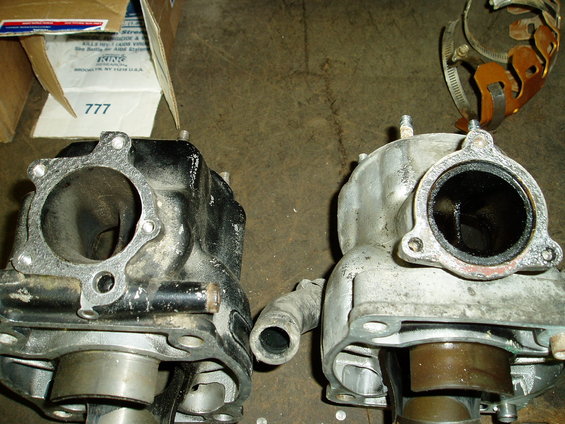

    I'm replying to this post but my memory may have faded some so don't take this as gospel..... The ATC and CR250 exhaust flange use the same bolt pattern, but the flange for the CR250 is much larger than the ATC flange.
    A larger spigot would have to be welded to your existing pipe to use the CR flange on your ATC. This was a common modification regardless of cylinder choice. If ATC jugs were used, the CR flange was installed and the exhaust port was modified to blend into the larger flange.

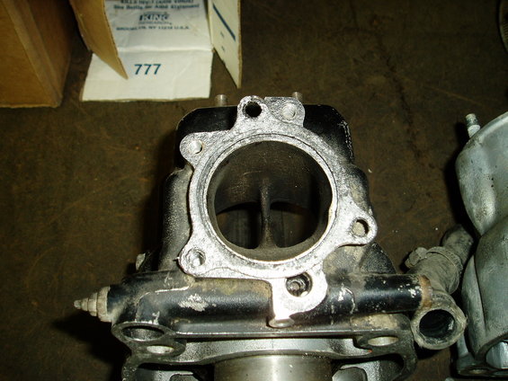

    since the atac valve is removed the bolt patern is way different ,,, its not even close . there are 4 bolt holes in the cr cylinder, and one is to close to the edge to use too,,, i redrilled a billet flange and got 2 bolts to work , the inside diameter of the flange is within thousandths of being the same size as the port,, which is larger than a atc cylinder by quite a bit,, its even larger than a pro-x 310 i have too,,,,,,,,,

    Here's a few pics of the exhaust ports side by sides. This is the ATAC cylinder minus the powervalve.
    ATC flange gasket on ATAC cylinder.
