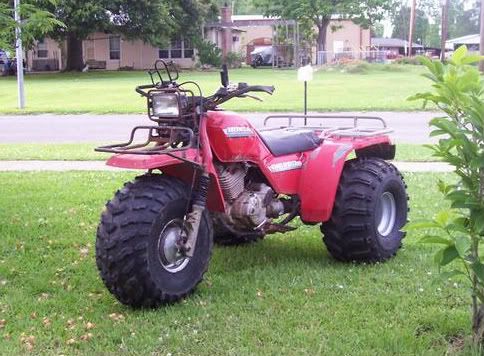

    How about something like this? Stock size with wheel spacers.
    [IMG][/IMG]
