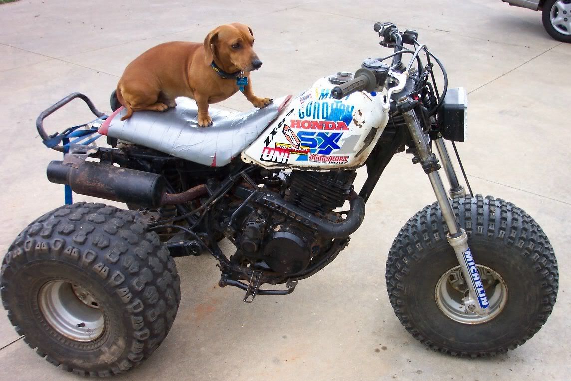

    iu was bored with my SX also so I did a few cosmetic mods and so far I love it!!!
    Feb 2008
    Mn U.S.A
    41
    haha its looking good man! ya i was looking more for trail riding and mud but i also like speed haha
