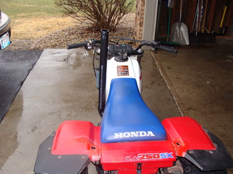

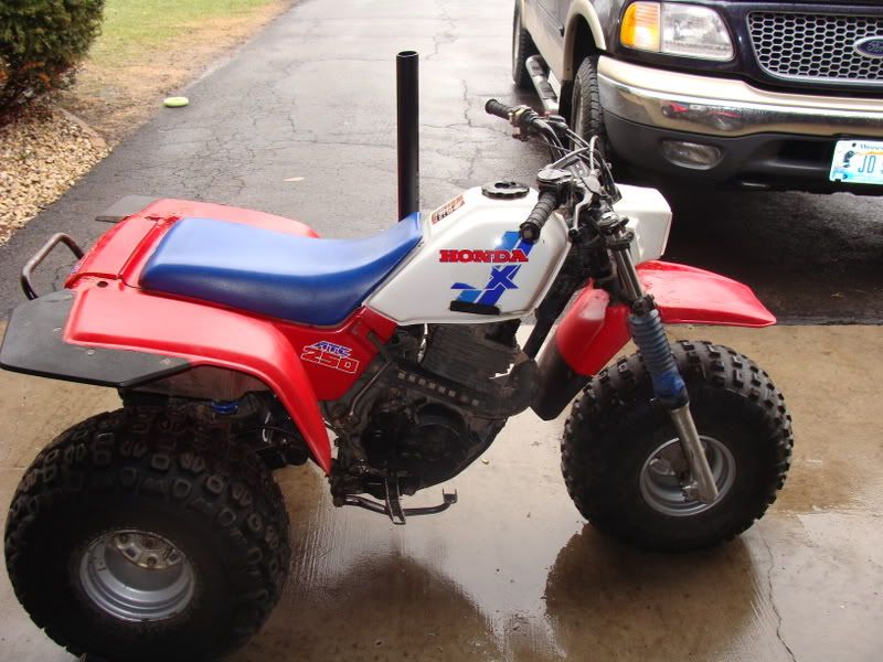

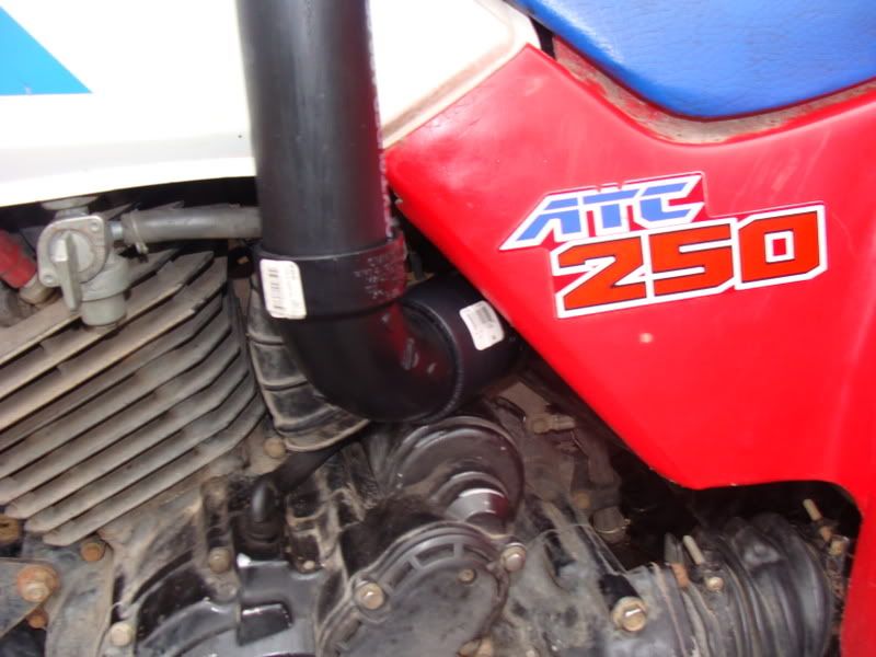

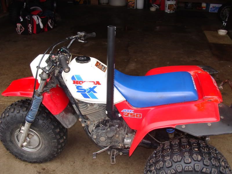

    Hey guys I just finished my snorkel for my 250sx and it works great!

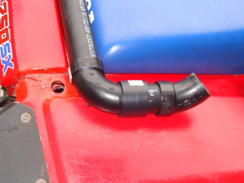

    It is made out of 1.5 in abs pipe. It is a inline 45 and a sweep 90 connected by a short piece of tubing and then the long stack part. Its really nice because it sl ips right into the airbox and is removable when wanted.. i am thinking about extending it to the back of the wheeler by the grab bar in order to avoid bumping it while riding. Now all i need to do is figure out a way to make an exhaust snorkel...

    Came out great, that vertical pipe needs a clamp somewhere...

    yes make shure you run your vent tubes up to the same height as the snorkel so you dont get watw rint he rear and motor.

    Yeah...... Umm did you sit on that thing and ride it with the pipe up at all? Looks to me like the pipe would be jamming in the bottom of your helmet and be in the way of your leg. It should work though.

    ya i did and it does kind of get in the way thats why im probably going to extend it out the back by the grab bar then it should work really well

    I've run this snorkel setup for water crossings for over a year now; it works great. It doesn't really get in the way, I can steer full turns and not run into it with my arms and I'm not leaned that far forward to hit it with my body. I don't really notice it against my leg. As soon as I'm done in the water, I take it off. I have been in wet areas where I've just left it on between water crossings; normal riding with it isn't really any bother. I've never knocked mine off with my body (or anything else). Just be aware that it's there.
    I suggest either pipe a 180 on the top or drilling holes along the top edge like I did. Having just an open end is very easy to block with a shirt/jacket. Machines die quick without air and being in the middle of a water crossing is not the place to die. I thought it would need a clamp on the vertical pipe, but mine holds on just fine without any attachment there. I did stick a piece of electrical tape on my tank where the pipe was rubbing the paint.

    so how did you go about sealing the airbox and the carb up? im very interested cause im think of doing this to my 200s's

    i didnt have to seal the airbox or carb.. you just run your ventlines into the airbox.. i only had to seal around the hole where my ventlines go into my airbox and you can use anything pretty much for that

    you dont think water will seep in thrue the lid of the air box...do you have a pic of the air box and where the snorkel goes in at?

    threewheelin-feelin - My airbox lid has always sealed tightly enough on it's own. The pics are my of my SX; where the snorkel attaches to the airbox and where the vent lines are in the airbox.
