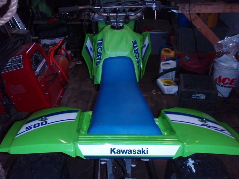

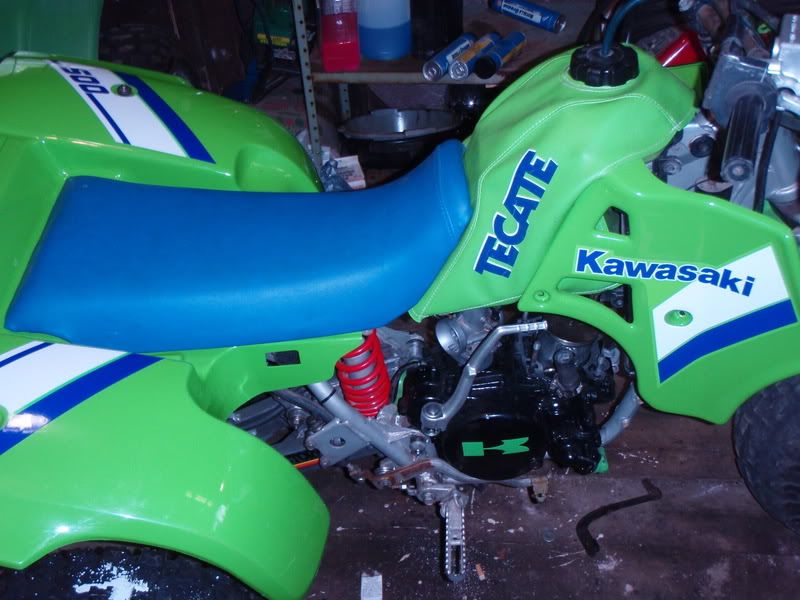

    I'll get some better pics when I can take the 500 out of the shed, she's just together for a mockup. The pipe is a PSI that was altered to fit, I'll get some pics of that, too. It's been a long journey with the 500. From making brakes to $325 replica radiator shrouds to obsolete everything! Two of the pics of my 85 are really old. The one in the shed is recent. It's got a nice CRF pipe on it. The thing rips!!!

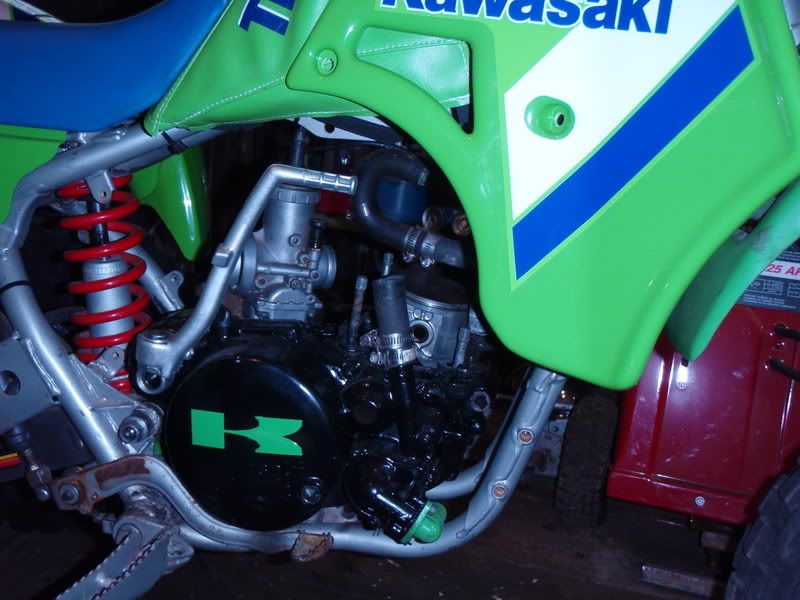

    Yeah, I'm new to this whole forum thing... I thought about it last night after I posted my pics and came to the conclusion that I probly should've started my own thread. Sorry! I felt the compression release was a good idea because I only weigh 145 lbs, and the guy I got the motor from said he used to snap kickstarters all the time. I paid $100 for a brand new kicker, and I'll never have to do it again. I hear it'll kick over like a 125. I got a little K&N that will fit, but again, it's little. If you look closely you'll notice my red shock. It's off a 400EX. It was almost a bolt-in. Just a couple small mods to get er in. Unfortunatley, it's upside-down. I'm hoping it doesn't affect it being that way. I have the stock shock, but it's blown. I was looking to rebuild it, but came into many dead-ends. I saw a little info on another thread in here last night, but nothing definate. Anyhoo, this was my first time responding to a thread, next time I'll start my own. Sorry!

    Thanks BigGreen! How'd you get a 500 in the 85 frame? I was gonna do that but I ran into the problem of the KX exhaust port going straight into the front downtube for the frame. I was thinking of cutting that section of the frame out and building something different, but them I came across the 86 and grabbed it.

    definately not an 86 axle, it is an 84/85 carrier and axle. more then likely 84 judging from the hubs. also the rear disc and sprockets are from the 84/85 model. what also makes me say 84 is the rear caliper is an 84 model caliper. but it does look like an extended axle, which is nice. cant wait to see this thing all painted up finished. nice work.
