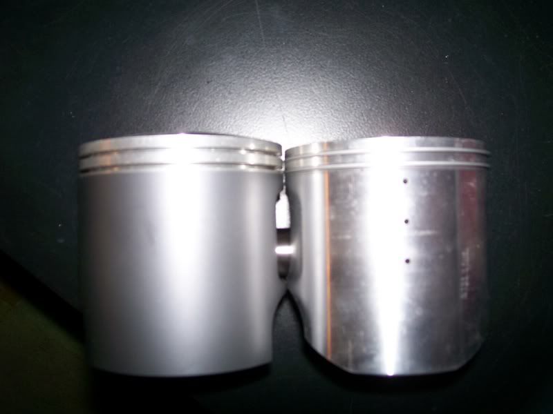

    My son is a member on these boards. 1upfront is his screen name. The old aircoolers are his passion. He is running a piston for the 330 big bore liquid cooled Rs in his 300r. You need to have the bottom of the cylinder milled down in order to run them though. They are a little shorter than the stock 300rs. His is a real screamer.
    Here is a picture he took of the two pistons with the pin in both to get an idea of the difference. The one on the right is the wiseco/lasleeve piston, the one on the left is a stock piston for the 300 cyl.
