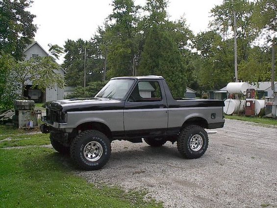

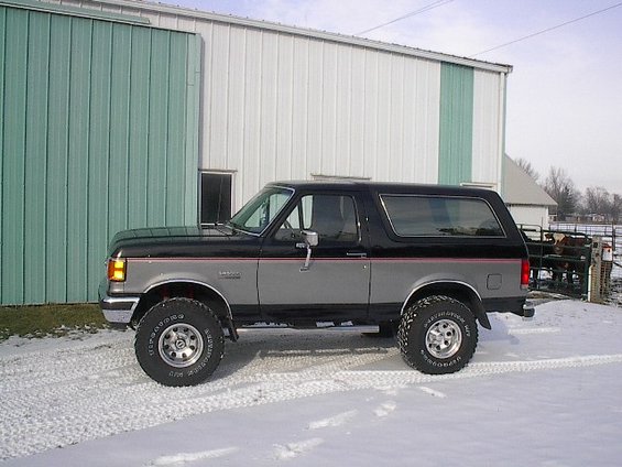

    Got a question for the painters/bodywork guys. Do you know of any books that go into proper datail and depth on how to correctly wet sand and polish clear coat finishes?
    I have a bronco I re-painted a couple years ago and for my first ever paint job, it turned out pretty good
    It has a couple runs in the clearcoat and some orange peel on the rear fenders. Basically I've looked over a few books and many magazine articles on painting and while they talk about wet sanding/polishing, none of them tell how. Here's what I want to know:
    - What kind of polisher should I look into (I'm a beginner and no expert)
    - What kind of pads and polish do I use?
    - What grit paper do I use to wet sand before I polish?
    - What is the proper technique for polishing?
    - What order of polishes do I use when polishing?
    Sorry, just kind of frustrating to come up basically empty handed. Maybe I'm not looking in the right places, but I'd like to find a book that I can get read up on that covers the proces of sanding and polishing in great detail. Already got books on painting, just not the polishing. Thanks
