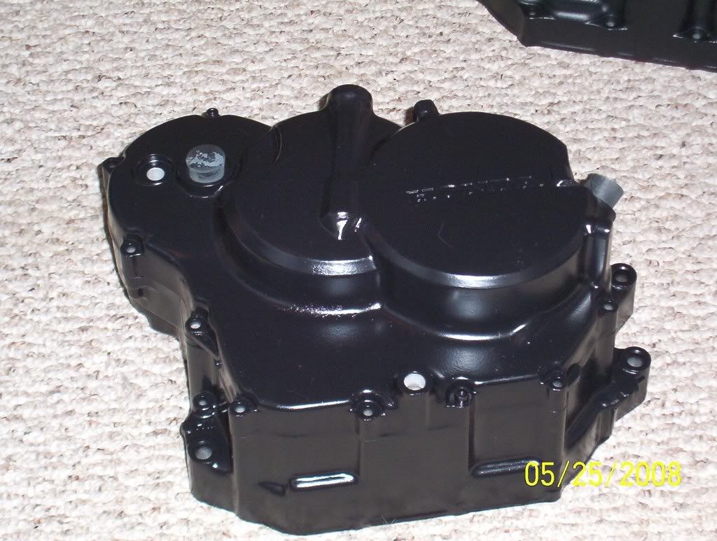

    Day 7 was a loooooooooooong day. Got in at midnight, off to be with no 3WW or even a shower.
    Bretts 350X rear bearings were SHOT The axle nuts would not budge without gobs and gobs of oxy/acetylene. Then I put him to work blasting.
    DEEPA used Gorilla Glue a nutty bar and Q tips and got his Tri-Z actually turning again When that kid wants to ride, he gets it done regardless of self inflicted injury or public endangerment

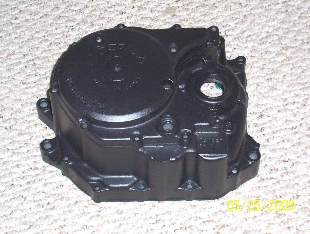

    Got the cases powder coated
    Right case -
    Left case -
    Learning ALLOT about this stuff. It's allot like paint, anything foreign in the air will end up in the powder finish. I coated the left case 1st and apparently did not use enough powder as after 15 minutes I saw some dry spots. So, I recoated and the finish showed that but it still looks real good SOMEONE has to be the Guinea Pig!!
    The right case got more powder and looks mint!! It is most likely best to coat both the same way, same time, same oven. If I had stripper, I'd do the left case again but it really is just fine and super durable.

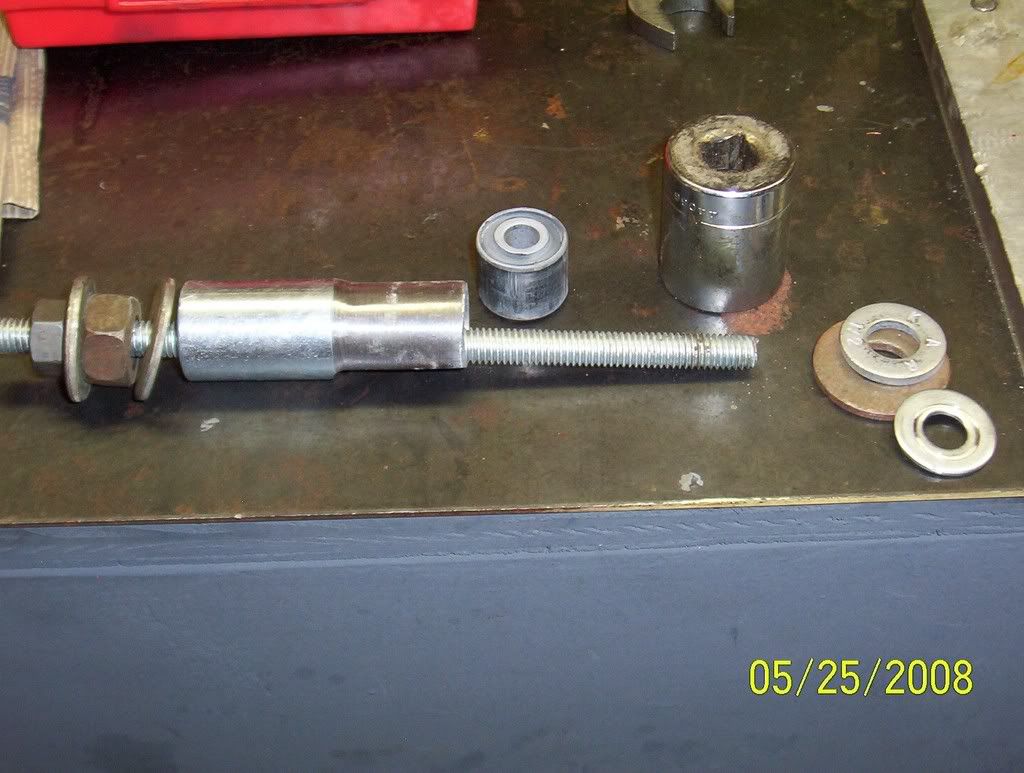

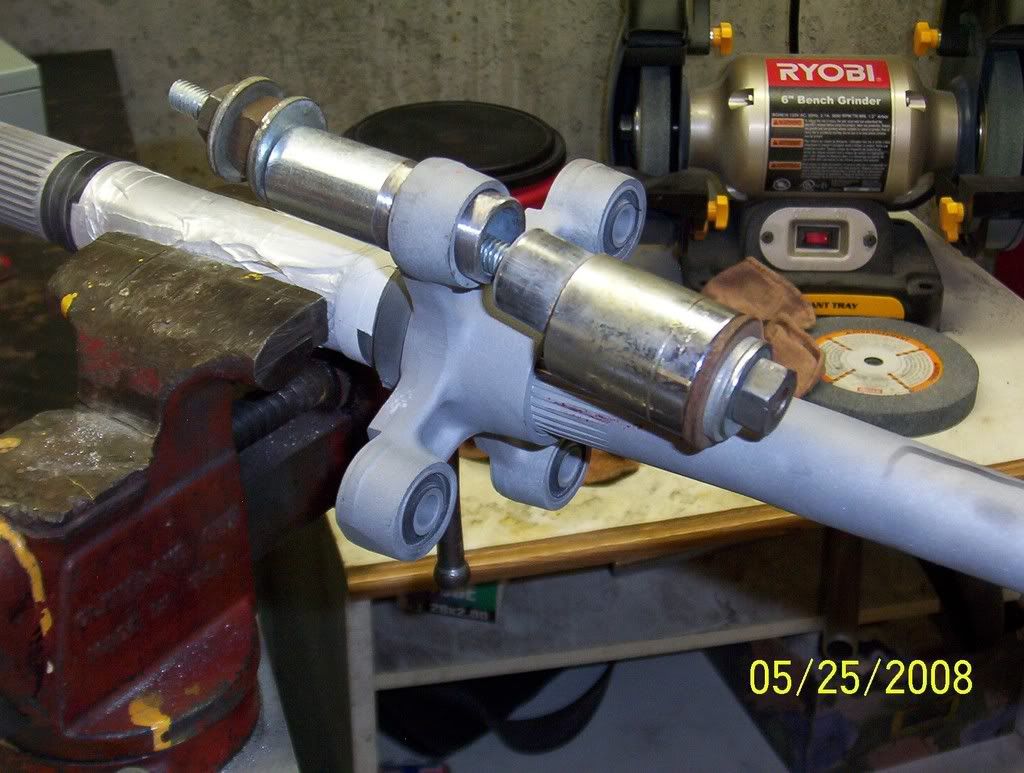

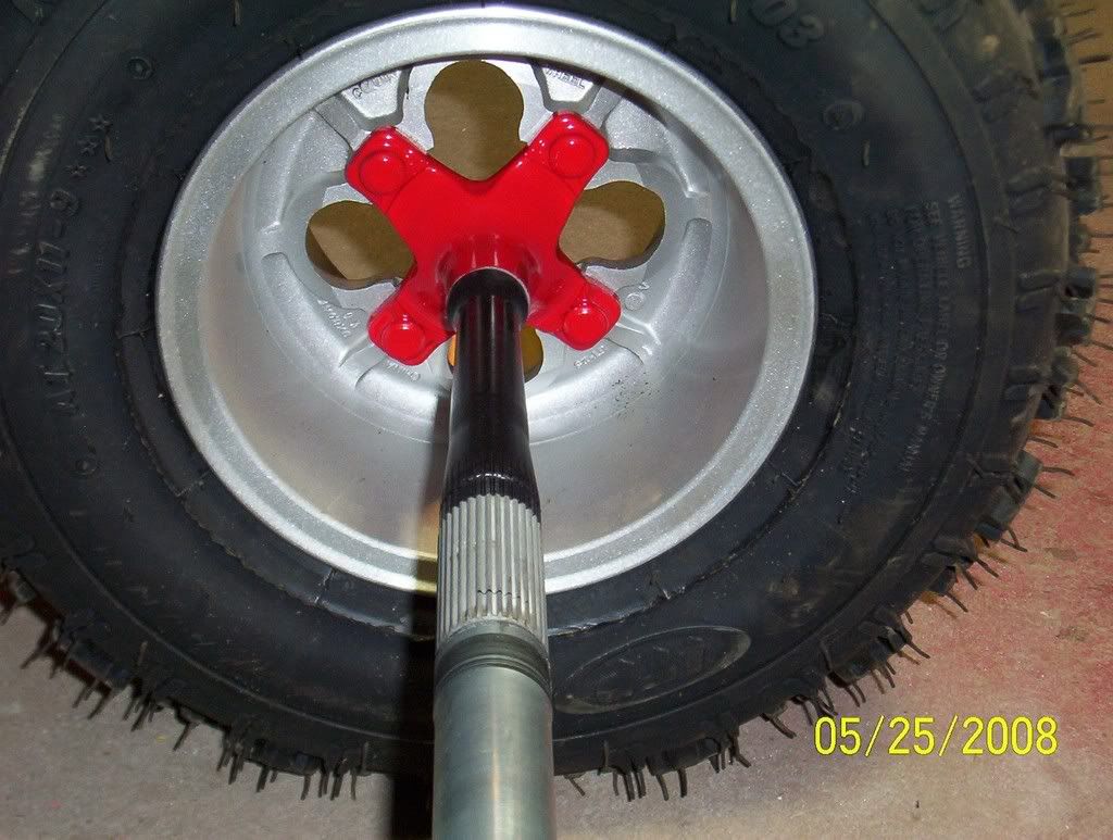

    Had to prep the rear axle for PC, removed the rubber sprocket isolaters
    I just used a simple tool from threaded rod

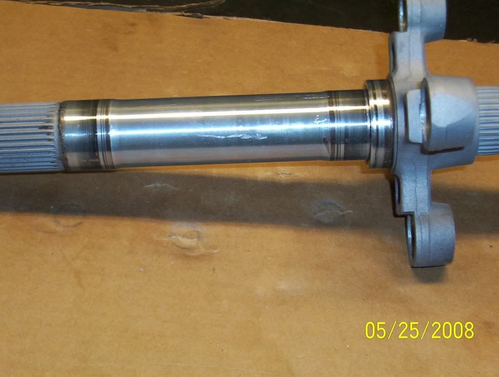

    The axle itself was MINT but of course it was all rusty where it's in the elements

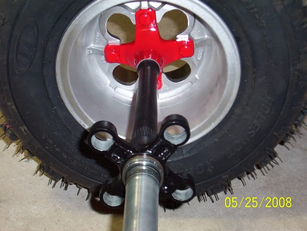

    Coated both sides of the axle along with the hubs
    Ya just can't coat the splines or you'll never get it back together. It's tricky figuring out what you can coat, what you should coat and what to never coat or you'll suffer dearly .
    The person I won the frame from won't take Paypal even with the dam fee..... I gotta see what I want to do there.
    Gotta pick up the cylinder Tuesday, coat it up and hopefully the bottom end will be ready by then. I'm gonna coat the whole topend at once so there are no variations in the shade.
    Jeff (Honda250SX) warned me about the oven temperatures, my oven at 275 was over 450 degrees, that didn't help the consistency of the 1st parts I coated.
    Still a ton more coating to do. Tomorrow I'll get the swinger done, the footpegs and some other odds and ends done. The bottom end will only take up a morni9ng so I'm in no hurry. I did remove tyhe main bearings and the crank is now in the freezer shrinking down as much as it can

    Thermometer came in handy didn't it. Now with more accuracy I can see the quality work starting to come out the oven. RED HUBS mmmmmm looks good. Who's red is that steve? Looks like two coats to me. It looks THICK. Nice and "plastic" like looking

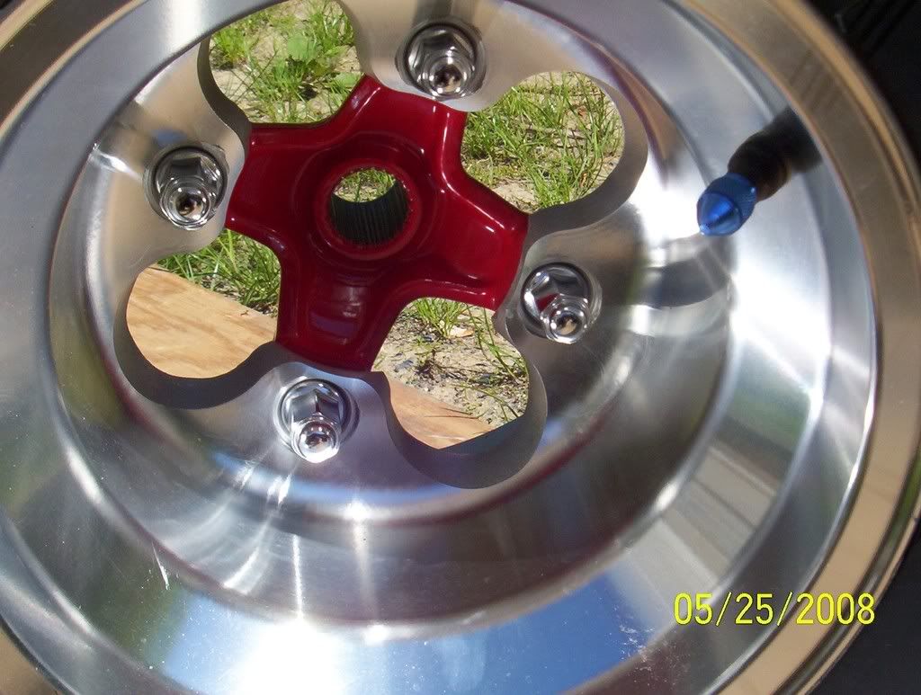

    Just the hub close up
    Here are the tires, rims and hubs
    Yes, hoping the oven will work better now. Maybe thats why the oven was free. The guy beat the snot out of his wife for burning everything

    the rear hub, tire and wheel assembly looks really sharp. Keep up the good work

    Holly crap! Steve, I almost got a chubby looking at those wheels and hubs
