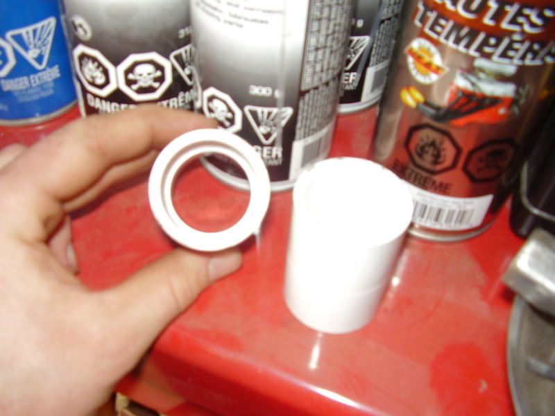

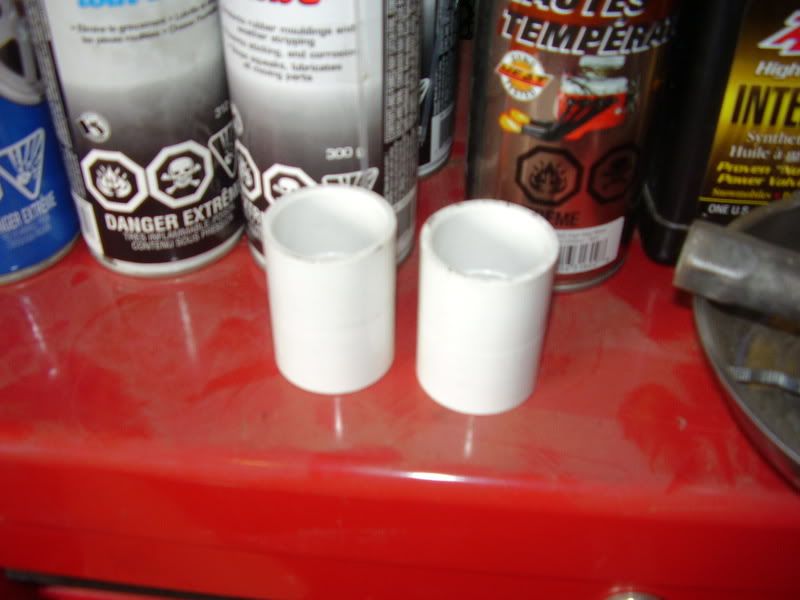

    Hey guys, got this at TSC its 1" PVC pipe
    is this what you guys are running in the front forks?
    Thanks alot

    thats pretty much what i ran in my 85 R, i havent ever taken it out to look at it but it seems to be working alright.

    Those are couplings which is fine as long as they fit. The 200CC forks take either a 3/4 or 1" PVC that has to be ground down just a bit to fit inside the tube. I'll bet that coupling is perfect for a 250R fork spring diameter but it's all the same crap.
    For the guys that cut there own, you have to make sure that there isn't ANY PVC cut crap that can come off and work it's way into seal area.

    Do these go inside the fork tube? They look like seal savers to me. Where can you get seal savers?

    They go inside the tube and preload the spring.
