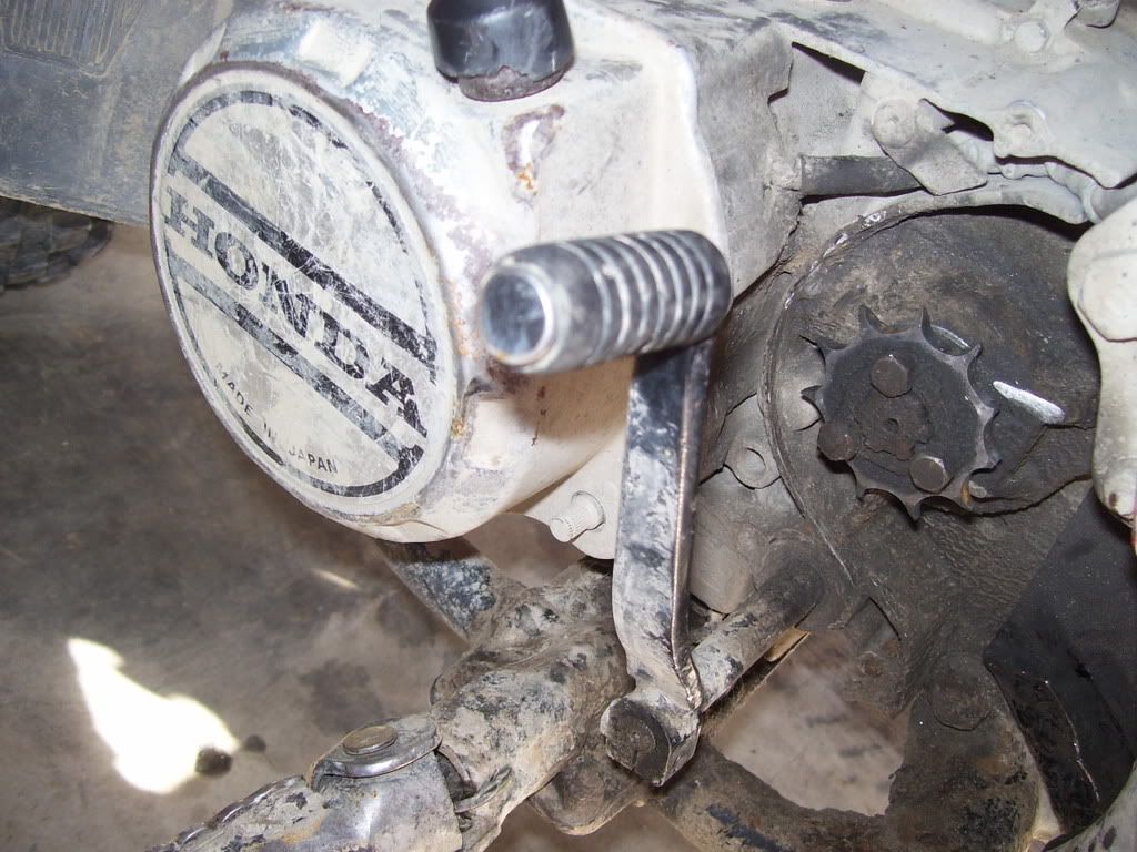

    the day before the ride i took it for a little ride around the tracks and my gear shifter lost its teeth. So i took one off my 200cc dual purpose chinese bike and this is what it turned out like
    I kick the shifter backwards to go up a gear and forwards to go down
    i put it on there the morning of the trail ride because we were all eager for a good trail ride and it wouldnt work in the normal position as it would just hit the round thing that the pullstart rope is in and i rekon it works better like that with my new mx boots afew times ive got it stuck in between gears when using my mx boots to change gears with the stock shifter

    new chain and sprockets would probably help the popping issue. Your front sprocket is shot, i never let mine get that worn.
    Jun 2007
    Washington
    115
    wow that front sprocket is way gone.
    i agree new sprockets and chain!
    Is it cheap to replace the front sprocket? There is no overly worn teeth on the back sprocket.

    Around 8 bucks from rockymountain atv for a cheap one. If any of the teeth are hooked on the back sprocket I would get a new one. Also alot of people around here just buy new front sprockets and use the old chain, and end up with another worn sprocket in a couple weeks. Just get a cheap sprocket kit with rear, chain, and front. It will last a long time if you keep it lubed and tightened. The problem could be you chain was severely stretched too.

    The chain seems in good nick same with the rear sprocket but i will see how much i could pick up all 3 for the chain came off the back sprocket all the time I dont think it came off the front at all. The chains been loose since I got the bike but never got around to tightening it until it actually caused problems. But i think ive learned now not to go out riding with a chain that loose because i almost could have stayed at the river over night and afew months ago a 15 year old girl was raped and killed at the waimak (she was found right on one of the 4wd off tracks that we ride thru)

    Waimak, with the front sprocket in that bad of shape, you need to replace all 3 items. I wouldn't recommend riding that trike until you do. If that chain flys off and piles up around the front sprocket, it can do some serious damage and you will be on a steep learning curve regarding broken engine cases, busted output shafts and broken tranny gears. Just my .02.

    Yeah what freewheel said, once the front gets that bad the chain is almost guarenteed worn, even if it dosent look it.
