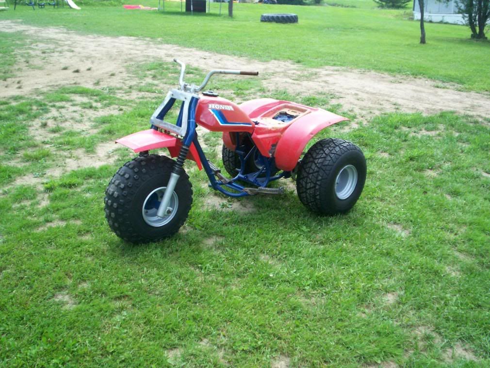

    thought i'd throw some pics of this up. wifey's gettin ready to go to work. i'll try to add a little story later tonite or tomorrow morning.

    Now that's gonna be one neat little cruiser!

    oh man, your right.. gonna tweak the 185 with a 200cyl, cam, and some other secrets.. what ya think??? does it look all right so far?

    oooh yeah, almost forgot. another board member is hookin me up with some folding steel footpegs and a wider axle.

    Gonna be SCHWEET! will it be done in time for some flat trackin over brapps this winter?

    What is up with that thing on the front of the upper forks?

    I think that polished aluminum or w/e on the forks looks killer, Gives a sporty look.

    thanks for the comments guys. i love to pull these old bikes from the weeds and bring em back to life. i have no before pics but it has certainly come a long way.
    chris, my plan is to have it runable for pennsyltucky. i really need to find a seat though. i have most of what i need to finish other than a few engine internals.
    thanks irvsled, the aluminium piece i made as a number plate. if also mounts the 200x front fender. it will be getting screened in the center and i'll be painting it red along with the fuel tank.
    brapp, i cant wait to bring her down and run it on the track! it would be awesome if you found 1 to do up. these things are cheap and everywhere. so far i have less then $50.00 into it. when done i hope to have no more than $500.00 invested. what im lacking now is a seat, cam chain guides, cam chain, and some gaskets. i'll also be runnin a clamp on filter since it did not have an airbox when i got it.

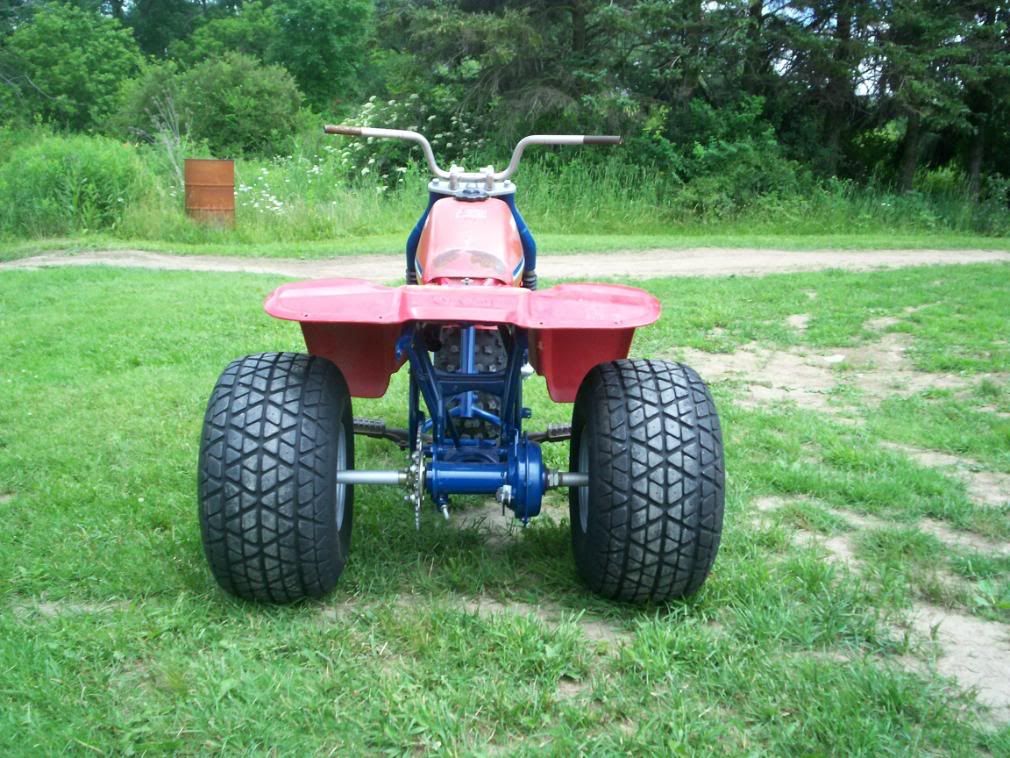

    Those rear tires look like street tires or something.

    sg? whatever? the rears are from an old school yami lawn mower. FREE from work!!!!!
