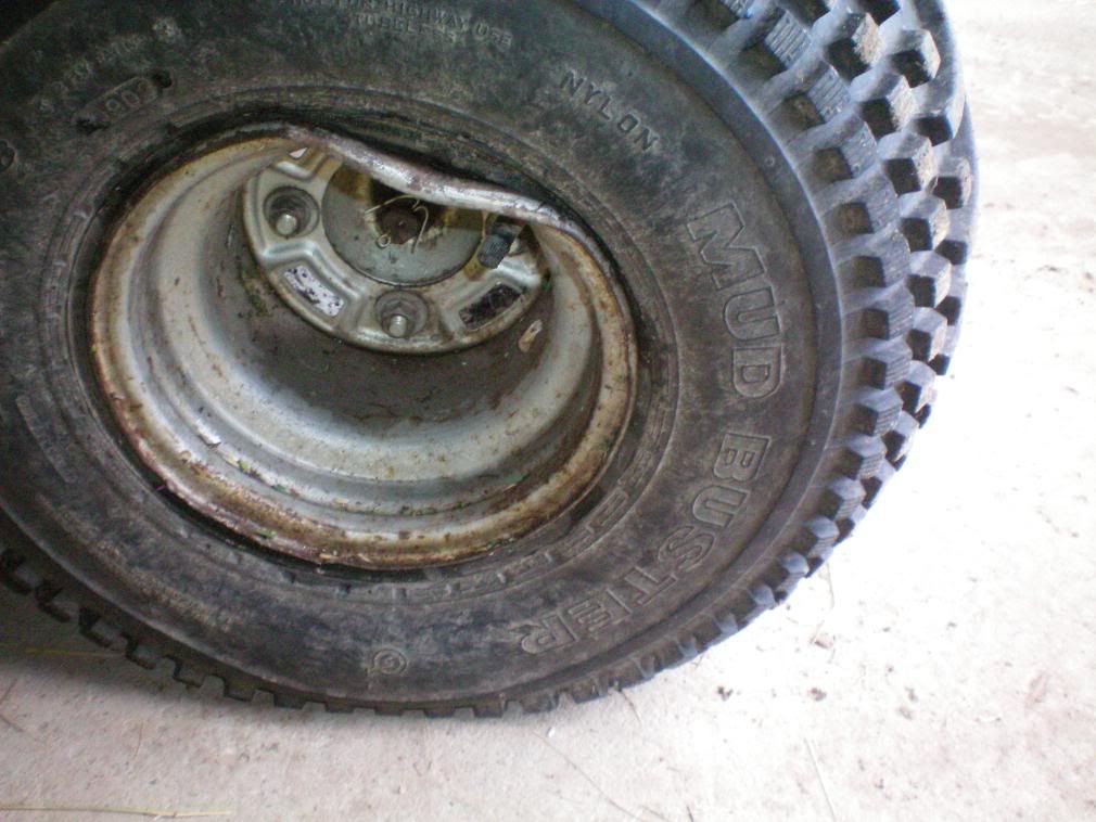

    So i bent my rim today and the tire now goes flat after riding for a few. I got a pic and am wondering if it is fixable or if anyone has a spare rim around?

    take the rim off the bike and beat the ever living "EDITED" out of it with a sledge to straighten it out, if you cant find another rim

    Thats a steel rim and oxy/acet can fix it up fairly easy. I'd just break the bead on that one side and shove something in there to keep it away from the heat.

    DC - my father is relatively good with a torch, he looked at it and said it was shot. You really think is fixable? Wouldnt this weaken the rim, bending it that is.

    take a piece of 2x4, put it at the top of the bend, then hit it with a heavy until it is close to where it belonged. I have bent rims like that before and the 2x4 did the trick.
    The wood will prevent you from denting and hurting the rim while you are banging it back into place....you don't even have to take the rim off of the bike to do this.

    The 2x4 method can work good. You can even cut it to have the same curve as the rim so it acts like a die. I've done this for an Explorer fender that was smashed in and it worked well.
    Don't be afraid of trying to straighten that rim by ing on it. It might come back. If it doesn't, it's not like you destroyed anything that wasn't smashed anyway.

    chrisD and Name Brand - i tried the 2x4 method and couldnt bend it. i got pissed off and then took the to it and still wouldnt budge.

    It's right on the lip which will make it tough to bend back but you can with some cheap body tools. A small bottle jack that can fit in the rim will work too or a air with a fat blunt tip. What the hell did you hit?!?!?

    Taiser, i am honestly clueless as to waht i hit or what hit me. i noticed my tire was low the other day and i go around to put air in and there she is.

    Buy the Rim!! Bending back a rim can be done but for $20???
    I have ridden a 3-wheeler with a rim bendt back and it always bounced down the road. It drove poorly and was unsafe at high speed.
