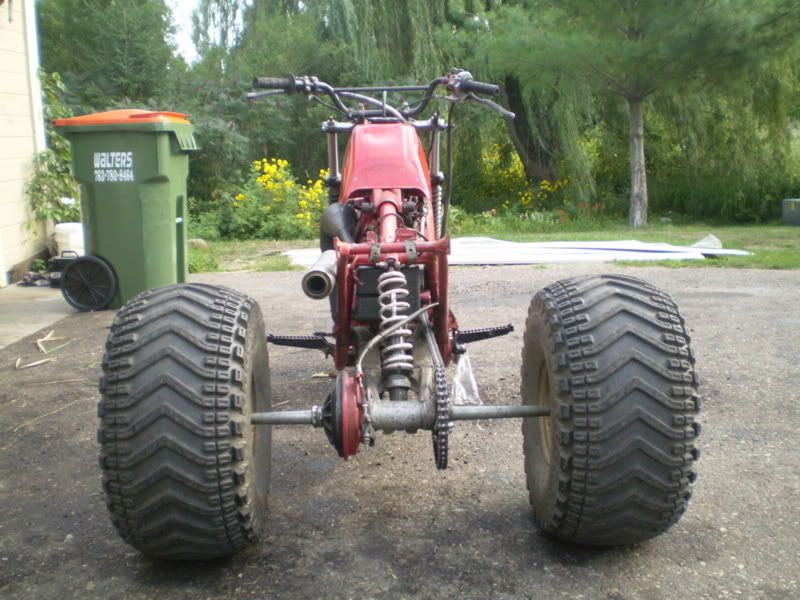

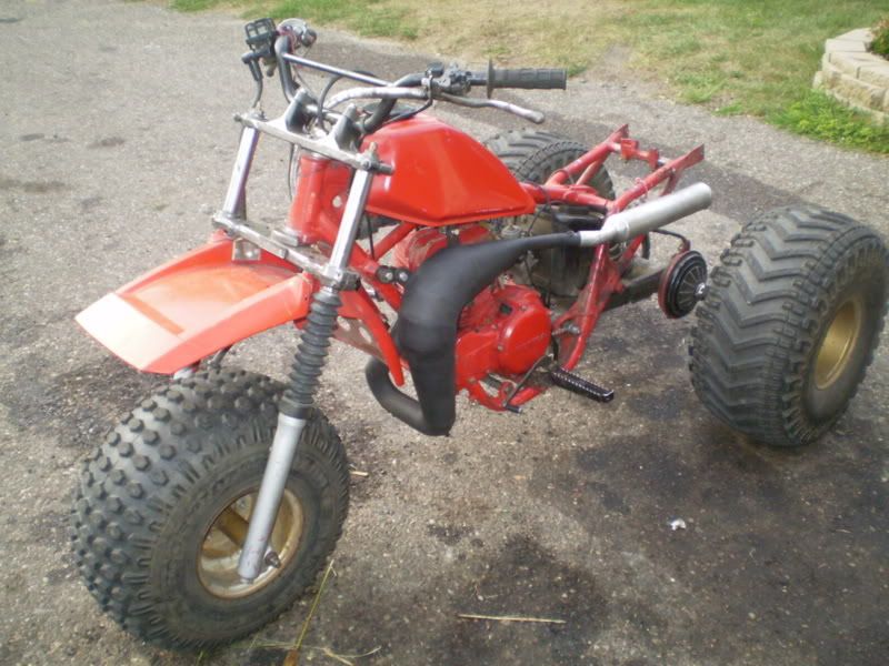

    Almost mint condition, it was hard getting it on, and i had to make some new mounts..Guess what i paid for it
    And I really didnt notice a change in the low end with it but it pulls alot harder high rpm..nice crackle..and its quite loud..

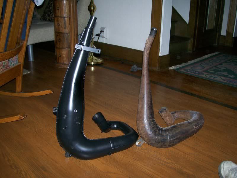

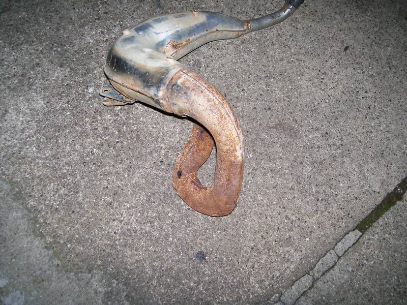

    I forget who made it but it was made just like the stock one and also looked just like the stocker. Here is a pic of the stock pipe that it replaced. It was severely rusted.
    Here is a pic of a mugen pipe for an81-82 The new black one and an unknown sectional for an 82-83.
