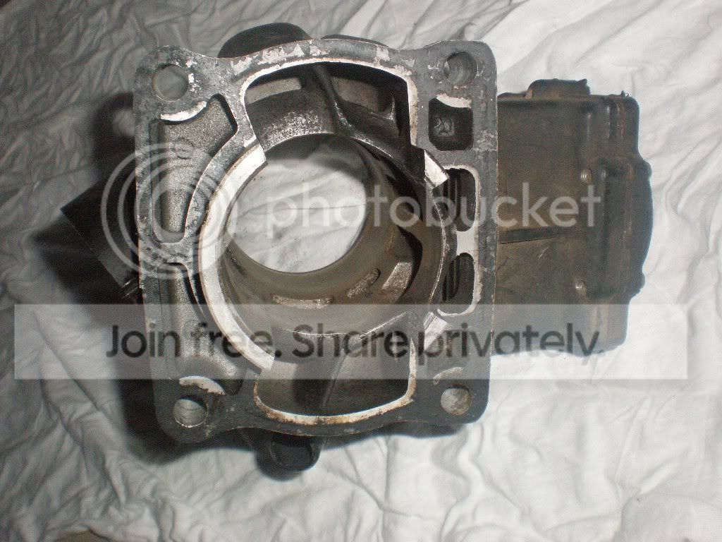

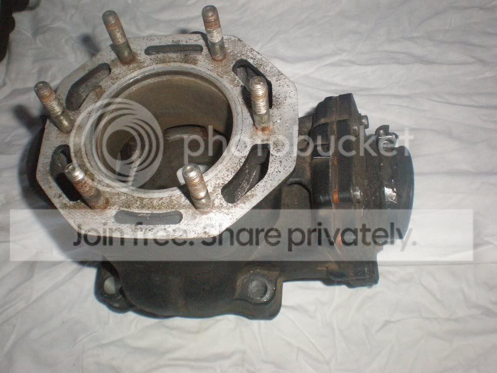

    Here is a pic of the top of the cylinder. It looks like there might be a sleeve - but this is the first cylinder I have seen so I don't know what they look like w/o one. Can you guys tell from the pic?
    Nov 2006
    southern oregon
    2,338
    looks plated to me
    Sep 2006
    Northwest Indiana
    1,893
    Yep, looks to still be plated, but badly worn at TDC.
