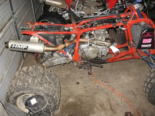

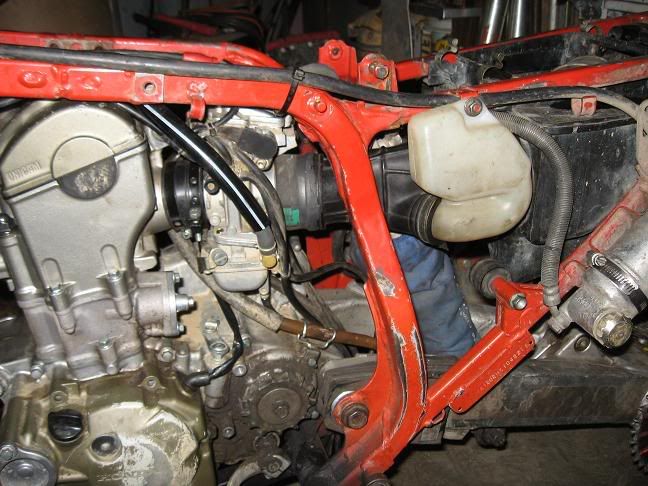

    I put a crf250r engine In a 87 TRX250r frame for my boy, and It friggin RIPPPS. It didn't take much modding to the frame In the trx, but the atc frame would be MUCH mor difficult. The lower frame would have to be modded like Gordon (250Rfan) did on his 450 3 wheeler. It can for sure be done, as 250rfan proved, but would depend on how bad you wanted to do It. The CRF250 engine pulls the quad around great. My engine Is bone stock, the only place I feel like It needs more power Is when you roll on the gas In like 3rd or 4th gear with me on It. With my boy on It, It pull just fine. I have seen on Thumper Talk where they get up to 45HP out of the crf250r & YZ250f. Torque Is where the small engine would suffer compaired to the 450r.
    Here's a few pic's of my trx/crf250
    http://
    http://
    http://
    http://
    http://
