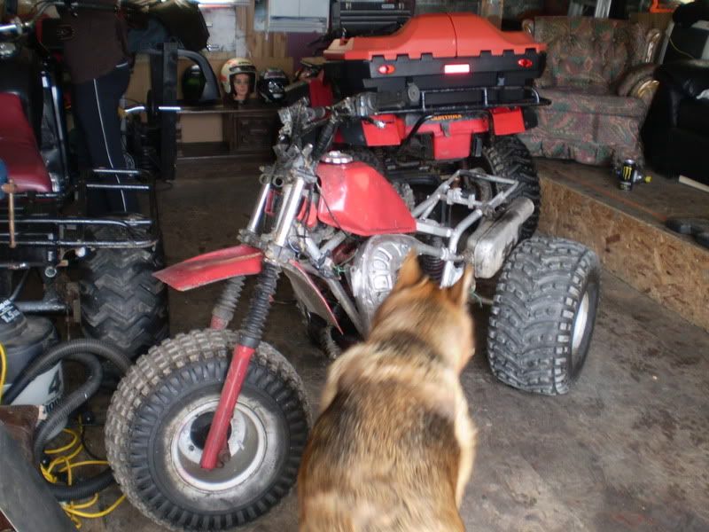

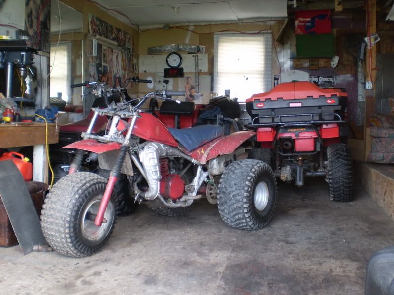

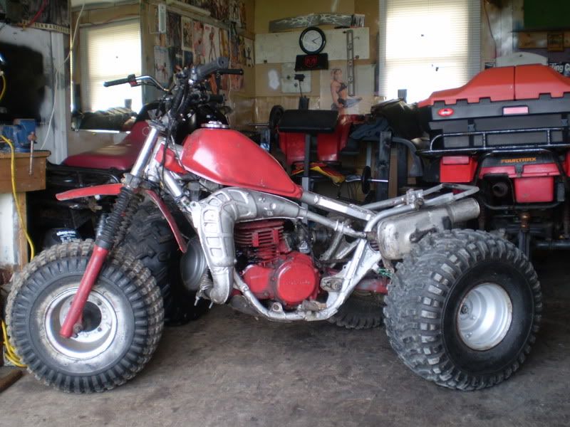

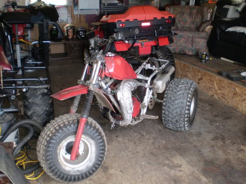

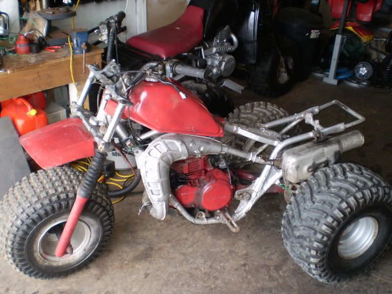

    A couple pics I took yesterday with seat and plastic that came with her. Kind of - take these pics to remember how she was before I start transforming her!
    Then my freaking dog decides SHE wants to take the trike for a ride!!!
    New trike dad?
    Can I take it for a ride?
    I know, I know - it has a clutch and I don't have opposable thumbs! But can I try anyway? Thanks!!
    OK, how do I climb up on this thing?
    Maybe this isn't such a good idea afterall?!
    Sometimes it sucks being a dog!
    Oh well, I can still chase you around while YOU drive it!!

    wow look at that pipe!! man..... I have a soft spot for old air foolers! I know I miss mine, it was a beast! the florida boys remember it!

    LOL, that poor pipe is being held to the engine by a couple muffler clamps and some exhaust flex hose. (it was in a mangled state and just 'came' with the bike, not on it.) It's a temporary solution until I can get a new pipe, thinking about running a DG - they are an upgrade over stock right?
    Right now it looks like I'll be getting a new DG pipe on there soon alongside a flatslide carb off an 86 and some power reeds. Should be a bit of of a boost in the power dept. ?
