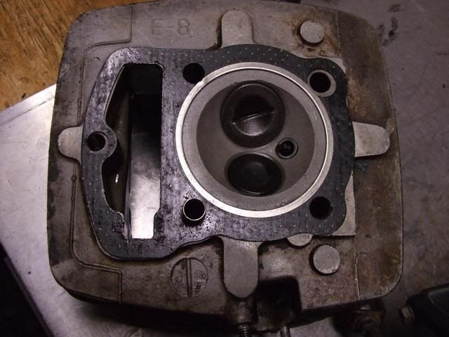

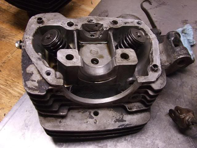

    So I had some time this morning to open her up.
    Head looks good:
    By the way, what is the slot on the intake valve on the pic above? Never seen that before.

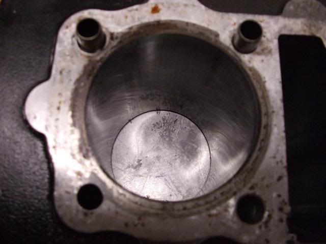

    Cylinder looks decent:

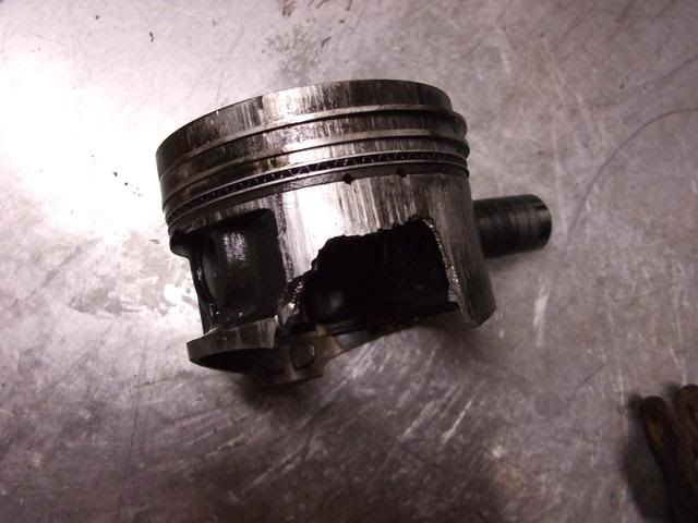

    Piston...... is toast!
    I thought it seemed funny when I drained the oil and there were little aluminum chunks caught in the screen. It shifted fine when I rode it and didn't make any funny bottom end noises. Should I assume the transmission is ok even though it has had chunks of piston go through it?
    I'm dropping off the cylinder today to get it bored and honed and a local engine shop.
    Rob
