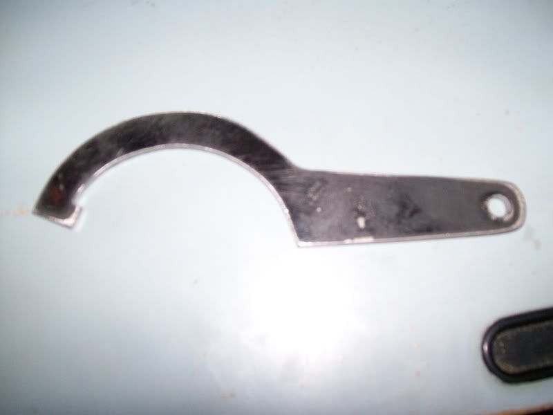

    I made this 83-84 R carrier spanner with a template I traced and I then cut it out with a cutoff wheel and die grinder then I filed it to finish it off, it was slow at work LOL.
