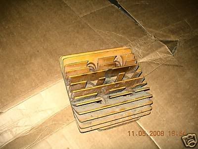

    i know this is the dg head it came off a fl250 but will it also fit the 250r? and the guy that has it is wanting $200 little high i was thinking

    that looks like ass if it came off a fl250, after 4 years of running mine it had small blackness and barely any pitting,

    It looks to be a dg.

    Yeah, that sunburst head will fit your 81-82 R with no problem, the 83-84 R though requires you to shave the fins down in one spot a little bit. It doesn't affect it's performance any. $200 is too much, especially now, no more than $125 for that one.

    I wouldnt pay 100 for one in that condition. It is a FL250 DG head though. Try to lowball him, a like new one is 250 or so.

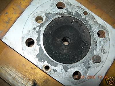

    The fl250 only has 4 cylinder studs so it wont bolt on an 81-84 atc 250r which has 6 studs. The other holes you see are for dowel pins.

    My bad, I didn't even catch that when looking at it! Good call. I was thinking of the sunburst head from an 81-82 R going on an 83-84 R. Doesn't the FL250 cylinder swap over to the R though? Also, from the top that head has provisions for 6 studs correct? You'd just have to drill the holes out larger right?

    1upfront knows his Rs. It wouldn't be worth the trouble to drill it out. All six holes would have to be drilled. The pistons will interchange though.

    I know the pistons will interchange. Will the FL cylinder bolt onto the R bottom end though? So the bolt spacing is totally different on the head? I'm just curious because I've had 3 of the DG R heads pass through my hands. I also love to know what can be swapped with what and what can be adapted.
