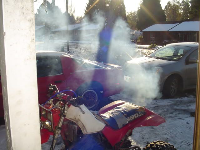

    350x smoking real bad look at the pict
    my 350x is smoking hella hardcore
    http://s148.photobucket.com/albums/s...t=DSC02992.jpg

    It looks very well maintained

    time for a rebuild and new plastics and make i a solid runner again

    damn and to think they did away with two strokes!!!!
    time for a top end rebuild it looks like, and yeah some new plastics and some love!!

    i bought the thing for $200.00 i just need to know what i should fix

    lol....everything...

    Quote Originally Posted by coleaclark View Post
    like i said in one of your other posts....a new top end and a fresh bore
    the new gasket kit should come with new valve seals

    Or keep it as is and there wont be any skeeters in your town next summer.
    But really pull the motor and get it gone over 100%, plastics wont change that smoke any...

    I had a honda 200e that was a bit worse than that. The piston and rings where from a different engine, so they didn't take the oil off the the cylinder as the piston went down, but it somehow had very good compression.

    spend a few bucks pullthe top end do gaskets and seals and if the cylinder is beat have it bored and do piston and rings, pay close attention to the cam journals they are usualy the first to go if the oil hasnt been changed or run low on oil. and get it runnign good and then plastics seat cover and one piece at a time.

    My 200x was like that when I bought it. Once I tore into it I saw the piston had cracked and a big chunk was missing lol. But it still ran fine! Just smoked like a train. The guy I bought it from put new valves and valve seals in it but didn't bother to check the piston. When he slapped it all back together and it still smoked he was pissed and put it up for sale.
