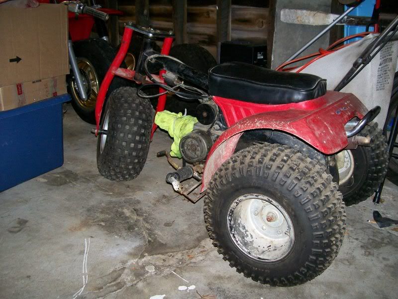

    I picked this up the other day. It is actually a pretty solid piece. No rust, very straight and complete. The guy was going to re-ring it because he said it wasn't running right. He got it all taken apart and lost interest in it. Other than being apart the only real issues I've found are the plastics were chewed on very extensively by his dog. and the seat was unprofessionally recovered. I have a few 70 engines and parts around so it should be a fairly easy fix. This is an 84 like one of the ones I fixed up for 1upfront when he was a kid. She is going to be all stock .
    I'm starting to make a list of the things it needs and after I get the new stuff I'll get started.

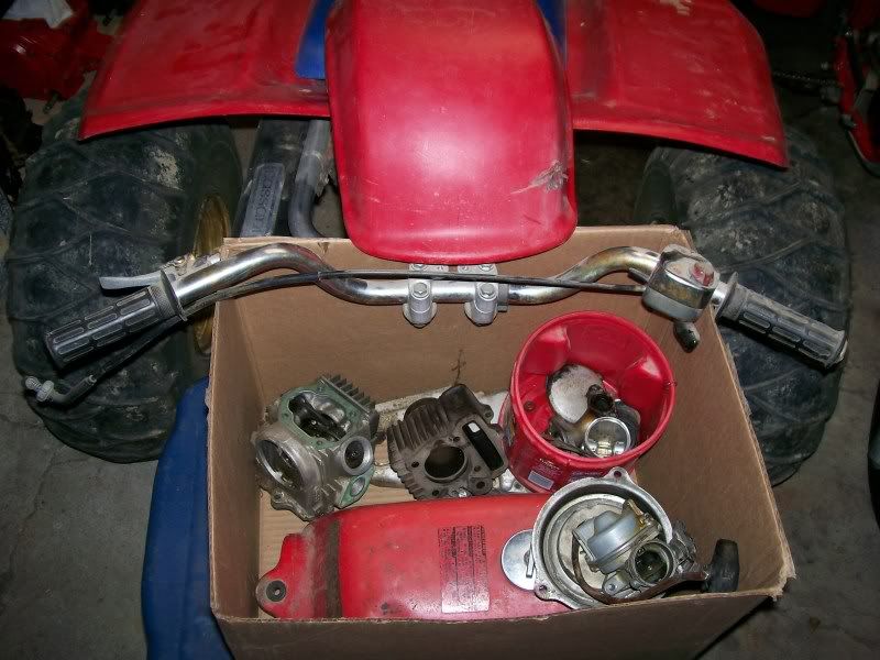

    Well we finally got a nice enough day to get out and dig through the parts archives. I dug out several engines and various boxes of honda 70 parts.
    Got the little bugger down in the " basement". A possible sign of things to come.
    Actually I have a big workbench down there where I will be mixing and matching parts trying to find the best combination.

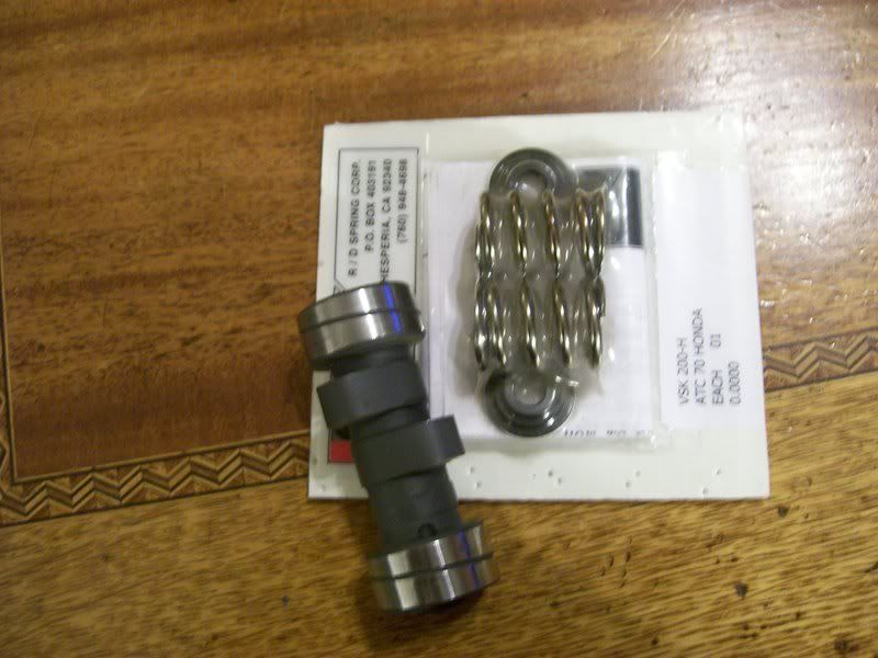

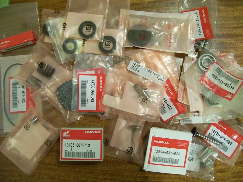

    Here is what went into this project. I still have painting and reassembly to do. It shouldn't be much longer before it is totally done.
    Seals, bearings, valves,etc.
    I went with a Web cam. It's a Honda cam that has been welded and reground.

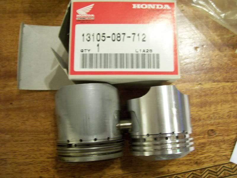

    The new Honda piston looks a little different than the old one.

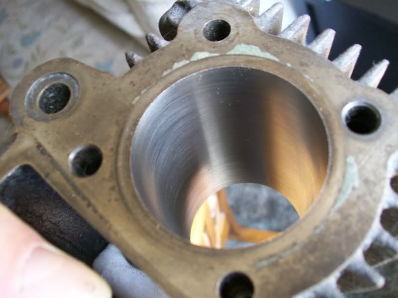

    I bought a couple rigid hones a while back so I used one to take this cylinder to the next size up. It took some time but turned out pretty well.

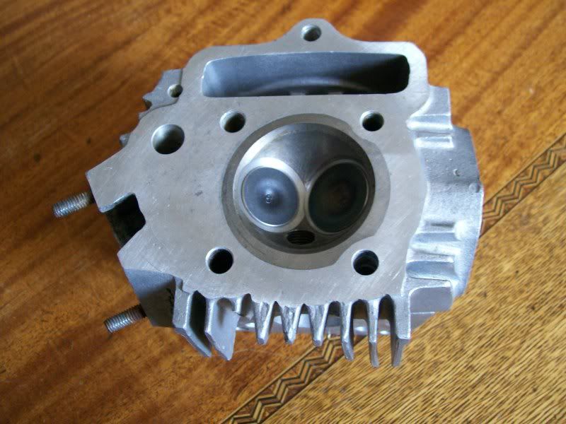

    I took the head to the local atv repair shop to have the valve seats recut and also had him put new valve guides in it at the same time. He did a real nice job for me.

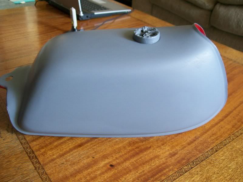

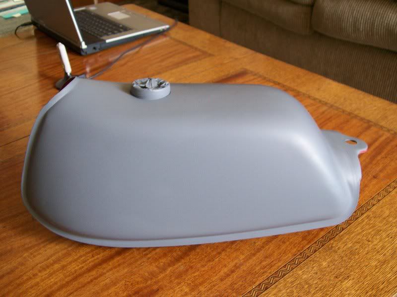

    Here is the tank ready for paint. 1upfront smoothed out all of the lumps and bumps for me. I will paint it soon.

    Do you have a scale to weight the new and old pistons. Or is the new piston a high compression unit?
    1984 Yamaha YTM-225DX
    Québec 3-wheeler riders group
    May 2007
    Coshocton, Ohio
    1,815
    Quote Originally Posted by Yamada View Post
    No I don't have a scale. The piston is a stock piston for a 1970 cl70. It is a little higher compression than the atc piston. I'm also using the head from the cl70. The head I took off of the atc had been broken and welded and I didn't want to take a chance on it failing.

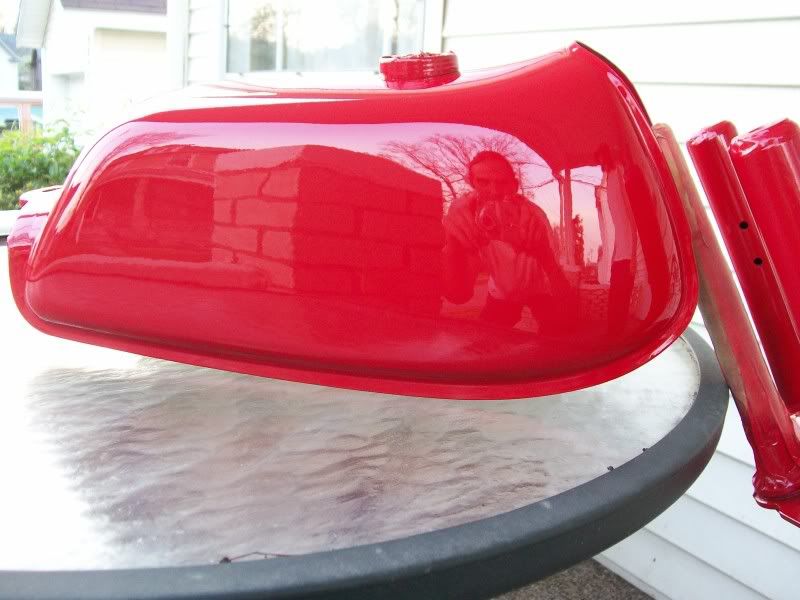

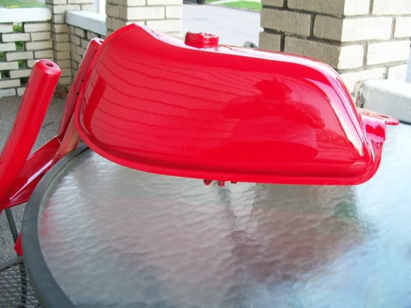

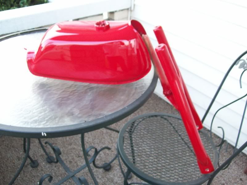

    Tank painted!
    I took on a side job this weekend that involved painting some motorcycle parts and that prompted me to paint my tank and forks,........finally!

    That paint job turned out really cherry. You should have used an xl70 engine if you wanted to stay honda.
