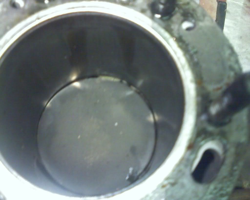

    OK so, you have to get a load of this.....!!!
    I had the jug taken to Smokies machine shop in Fergus Falls,Mn and he took one look at it and said thats not the correct piston for that machine. After looking at the situation he also said the jug had been bored 10 thousandths at one time and then the wrong size piston was put in (too small for the bore). That is what made the piston wear the jug oblong.
    here are a couple pics. Sorry about the quality, I only had my cell phone.
    Enjoy
    [IMG][/IMG]
    [IMG][/IMG]
    I do know when it ran it rattled and I thought it was the crank bearing but I stand corrected. He also showed where the piston had 3 cracks in it on the sides, right around the area where the pin holds the piston in place. A little more running and the piston would have let go..
    BANG!!!!! What the @#$^%@@#@!!! At least that is what I would have said.
    I am getting it bored and he will get me the correct one that will last another 20years.

    it prolly wasnt the wrong size piston, but just had too tigght of a clearence....wasnt honed properly
