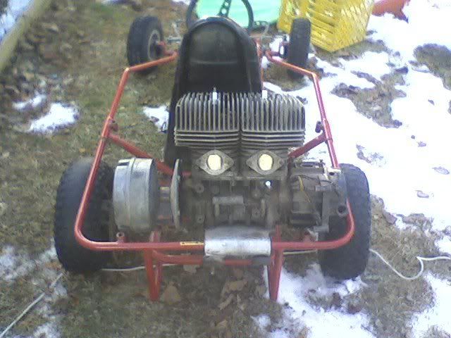

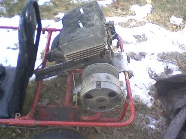

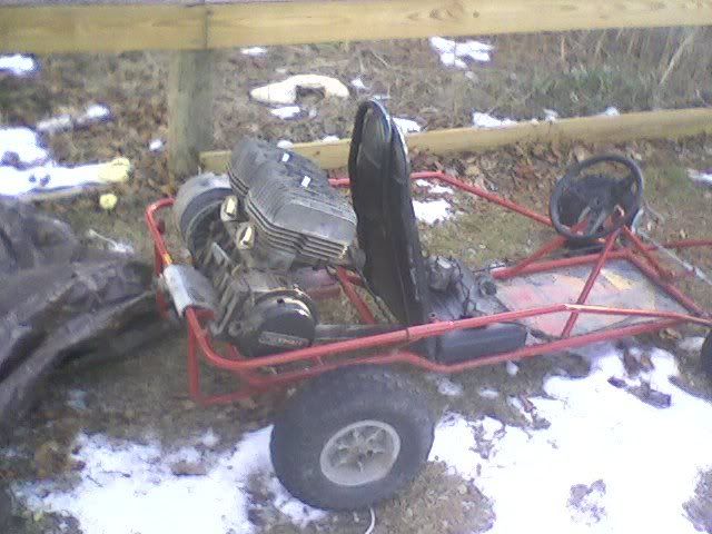

    this is the gocart project im working on right now it has a 500cc arcticcat spirit in it and will hopfully be operational soon

    Wow. Thats going to be a monster. But I would definatly reinforce that frame! That motor is probably going to vibrate like crazy. I had a gokart similar to that with a 350 motor on it and it was too much for such a weak frame.

    yea it use to be all bolted together but i welded the bolts fast and the butting areas but i still have to re enforce the rear some and change the rear axle to posi drive with a belt pully (lot bigger tires probly 12x16x6 hole shots and a new brake. the motor has been redone on the inside and will suposedly push "suposedly" 60-86 hp right now im looking for a really cheap jag carb and manifold body for the carb set up cause im really not looking forward to rebuilding the twin carbs cause its hard as hell to find parts for them i looked up the vin i just got the motor yesterday and found its from a 71-78 cheetah or cougar

    Or just change the gearing. Shifter karts use nearly 1:1 with such tiny tires. I would use a 4'' pulley on the motor and 5 or 6 on the axle.

    i actually found a set of sand paddles that are 18x26x8 and 22x10x8 and im running a factory 3" clutch and a 10" or 8" pully
