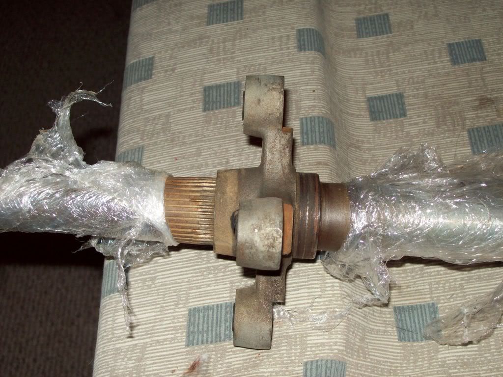

    Heres a few of the odd ball sprocket hub. Is this a 83-85 axle also?

    hey eric.... ummm..... why dont you look at your other 200x.....?

    I have and it looks just like my 85 set-up, but i don't have another 86-87 to compare the axle to.

    PM jason (longbedgts) he may have a good shot of his 86 200x axle

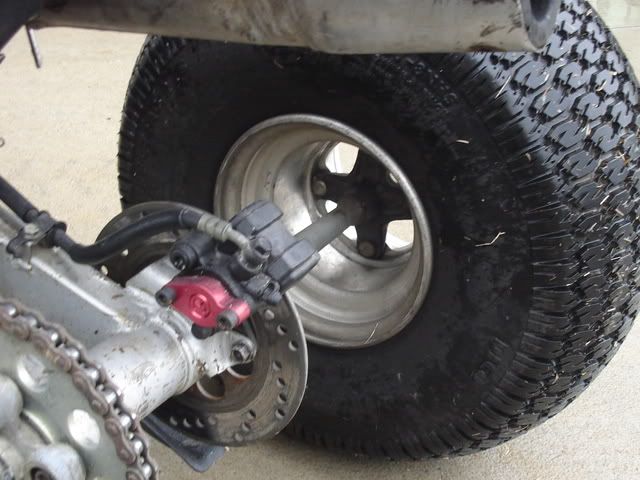

    Heres the best shot of the rear axle I have.
    84 Honda 200ES Big Red
  8. #38
    Louisiana
    145
    What specifically are you looking for pics of? I can get whatever you need tonight from my '87 X.
  9. #39
    17,489
    ERIC, sorry for the delay...
    There are 34 splines and 4 mounting points for the sprocket.....
    The splines are Appx 34.4MM or 1.350" Outside diameter
    The sprocket mounts towards the carrier and is nearly flush when mounted with where the oil seal journal buries into the carrier.
    I think the 85 may work just fine, might require some shimming?? And the stock 86 200X is 38 teeth, I'm not sure about the stock 85 200X but it could go a tooth or so either way if you messed with the front sprocket.
    I think thats the issue with the 84R axle swap, they may come with a 40 tooth stock ?? and I get them made at Sprocket Specialists down to a 36 tooth fr the durablue axle.
    I can take more measurements for you, whatever you need but yours is definitely a 83/85 200X axle and I hope you can make it work as these 86200X axles are harder to get than the 85 200X or even the stock 84 250R axle.
    Hope this helps.....

    Thanks DC! The 85 has a splined sleeve over the axle and then the hub goes over it. Anyone know if that sleeve is removable?

    Yes it does come off but man oh man does it come off hard! I had to heat the hell out of the one I did and press it out. At that point, you've rounded or flattened crap off that you didn't want to - it's really hard.
    Honestly, I didn't read all of this topic - but I'm guessing you can't get the 85 stuff to line up for you? If so, and you can't find a decent 86 200X axle, I'd just be sure to take a real good look at all the measurements before I dove into it. It's possible to ruin both hubs and axles trying to change them around.
    Eric, I might have an UGLY but good axle for you. I really don't like to sell my parts....... but I won't run it unless I have to and now I have a durable too. It may work great for your needs, let me check it out and see but I believe all the splines and threads are fine. It just has pipe wrench marks on it and rust...... If it's what I think it is I'd sell it for 50$ plus shipping.
