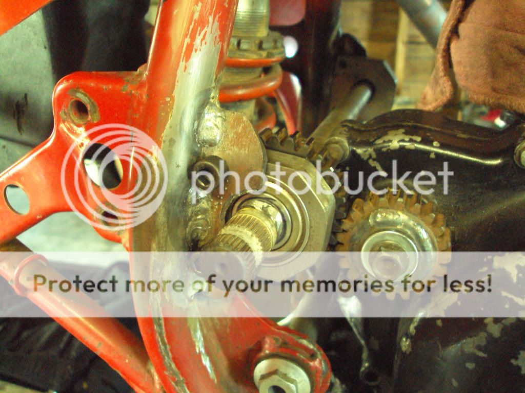

    I love the idea of the forward kick. I'm only worried about the strength of the frame being able to hold up to the welding/vibration/kicking on a daily ride, I have a feeling it might start to crack and the bearing gear assembly will rip out. I hope I'm wrong though and it works out.

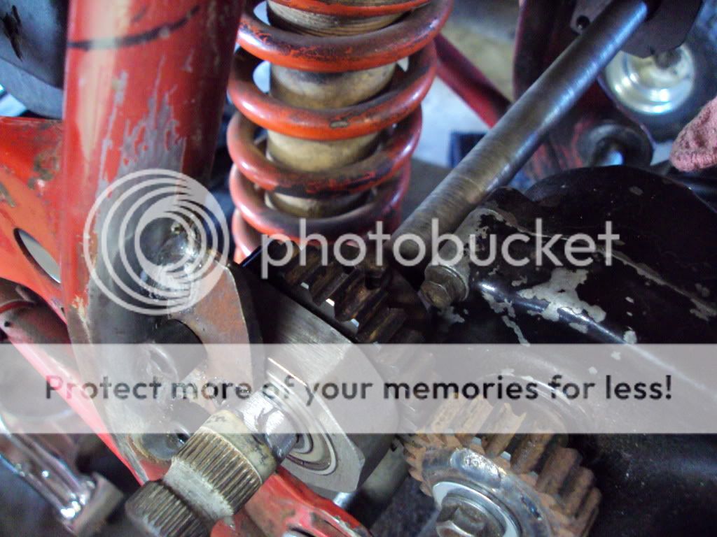

    i would definitely use the 2 plates for a sandwich, at least on the kicker side. better to overbuild it than giv'r a good kick and see it laying on the ground in a twisted heap.

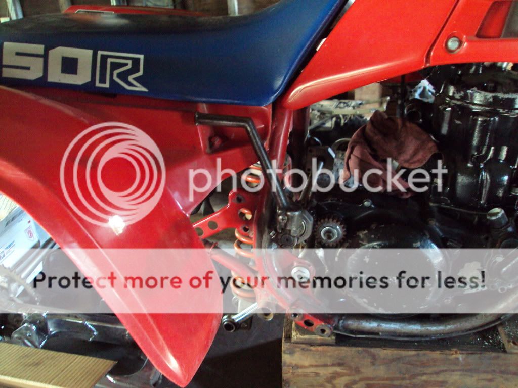

    Did some work and got it close. It is quite strong and I really dont think that it will ever screw up in any way. The kicker is close to resting in its home as is, so should be quite easy to give it a couple lil tweaks to make it perfect with Mr. torch
