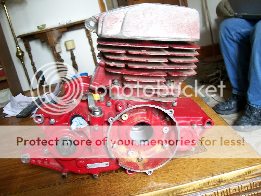

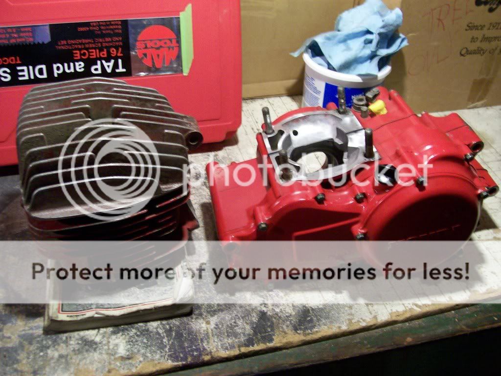

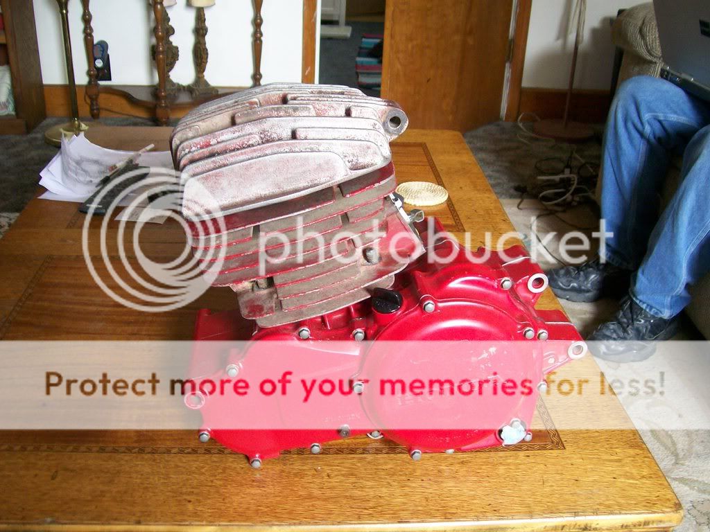

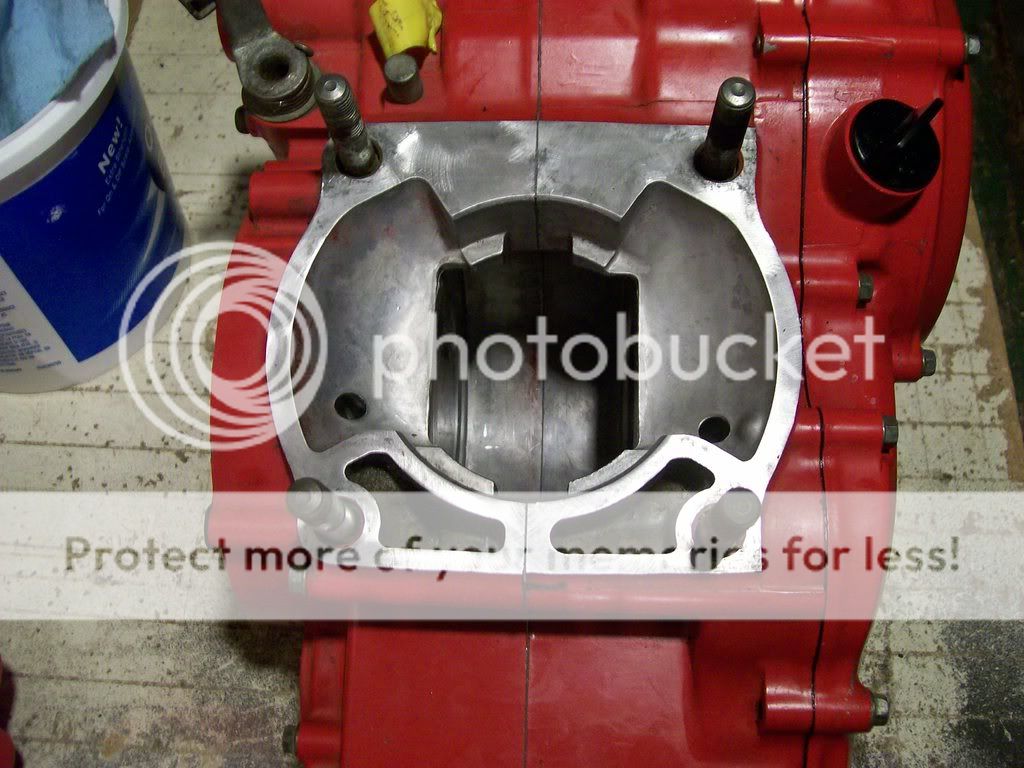

    I figured since my 300r motor has low hours on it there's no sense taking it all apart just to use the cases on the mugen motor build so I dug out a motor I bought awhile back from ebay and I'll be using it for the build, I'll be sending the cases to the machine shop this weekend for boring along with the crank to be drilled all according to the mugen instructions. Here's some pics of the motor ready to be machined.

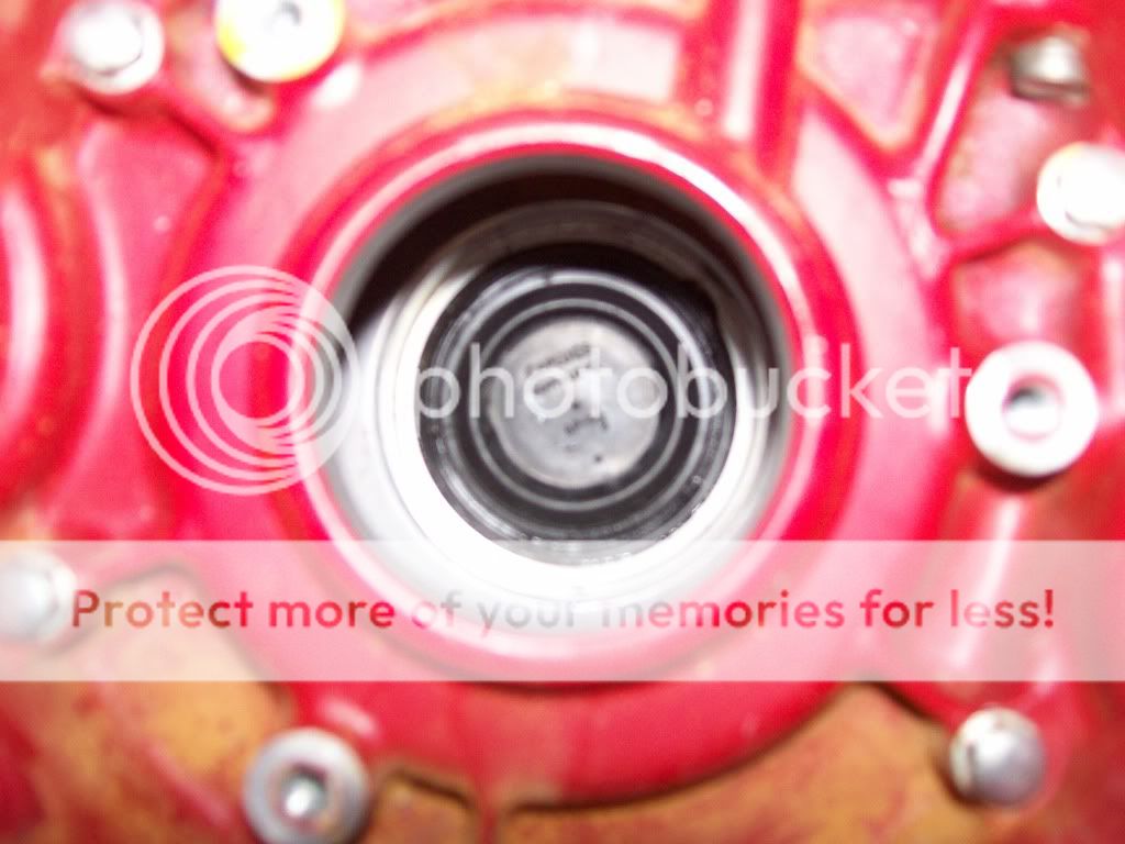

    Tranny all plugged off to keep metal chips out during the machine process.

    so that motor's... huge! nice find man

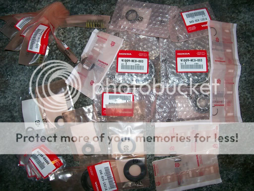

    I got some of my parts today for the mugen motor build, bearings, seals and so on.
    Airfoolers RULE!!!

    Quote Originally Posted by 1upfront View Post
    Nice to know all those parts are available.

    Here's a copy of the machine work needed for the cases and the crank.

    I got my cases back now I'm just waiting on my piston and crank, then I can mock it up and decide weather the piston will be usable, it's a polaris scrambler 400 piston.
