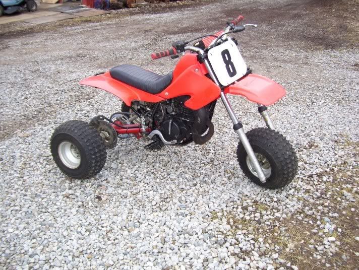

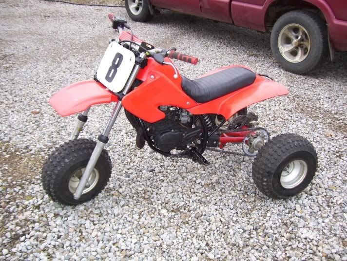

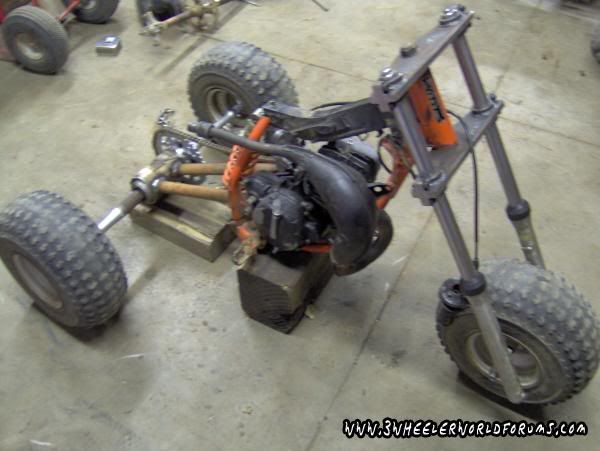

    I didn't use that many Zinger parts on my CR60 zinger. I used the plastic, seat & top frame backbone. The rest Is CR60 & custom made. I don't think Nathan would mind If I posted up a couple Pic's.
    http://
    http://
    http://
    The black rectangular shaped part Is all that I used from the zinger frame. That was just so I could use the zinger tank & plastic.
    http://
