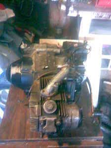

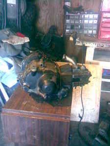

    Do any of you guys know if a 1985 Trx125 motor will fit in my 1985 125m? I know i will loose my Hi-Low range, but will it bolt in and will I have to change my wiring harness to one for the Trx motor? also do they use the same pull starter? I found one locally cheap here is the pics

    I would say as long as it is a horizontal 125 it should fit, just check the electrical plugs, the recoil is the same between the two, I just checked the part numbers by microfische onlineBut if you can try it out first thats the best way. All of the components in the recoil have the same part numbers between the two but the complete assembly part number is different--could be due to verbage on the cover plate mabey, but it should fit. You'll lose the low range in the gear box it looks like, but still have the high range.
    What's wrong with your old motor--is the transmission good-- I'm looking for a decent trans for mine. If you'd like to part with it let me know I'd be interested in it. Or if your not interested in the trx motor I might be, I don't care too much about the low range. I'm not sure if the attachment went or not it was just the part # listings between the two recoil assemblies.
