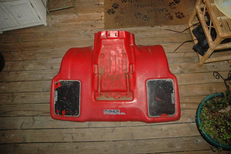

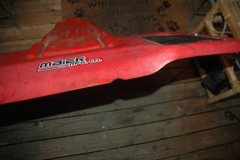

    Heres the pics;
    Nothing to ride... for now

    its alot better than mine... do you have a front by any chance?
