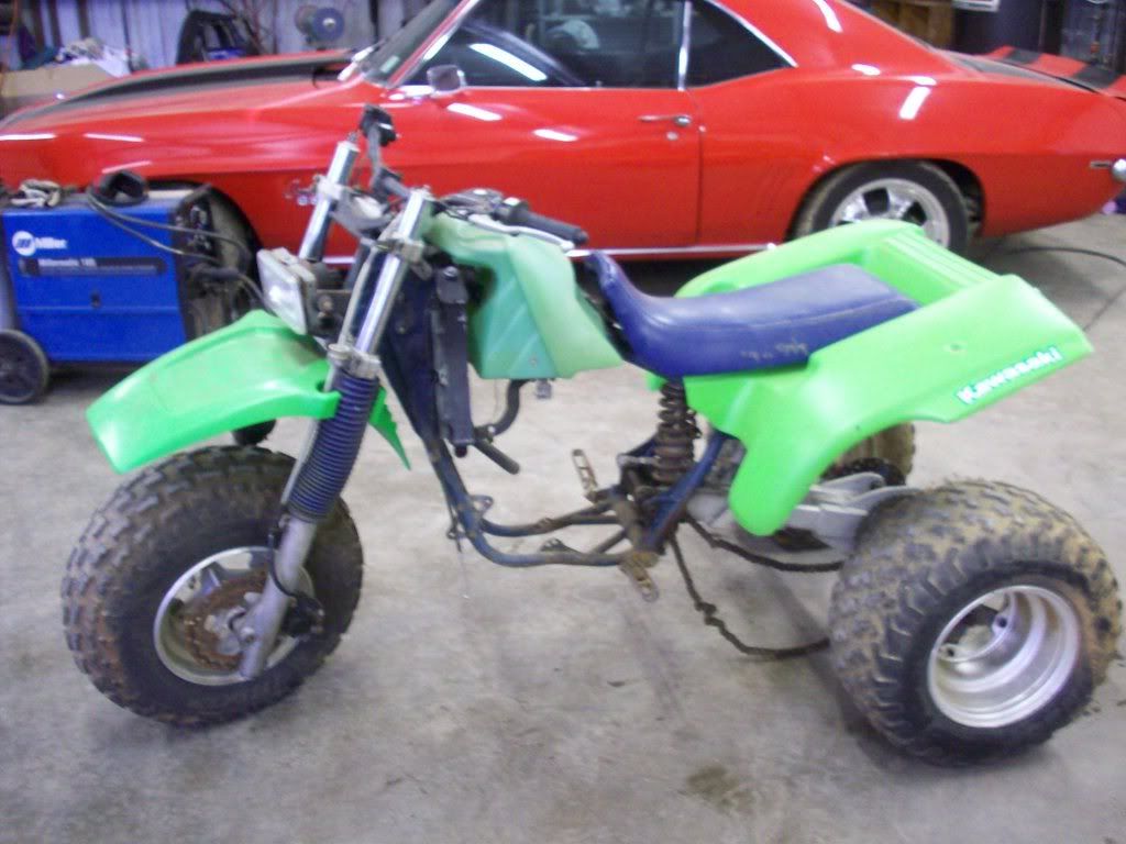

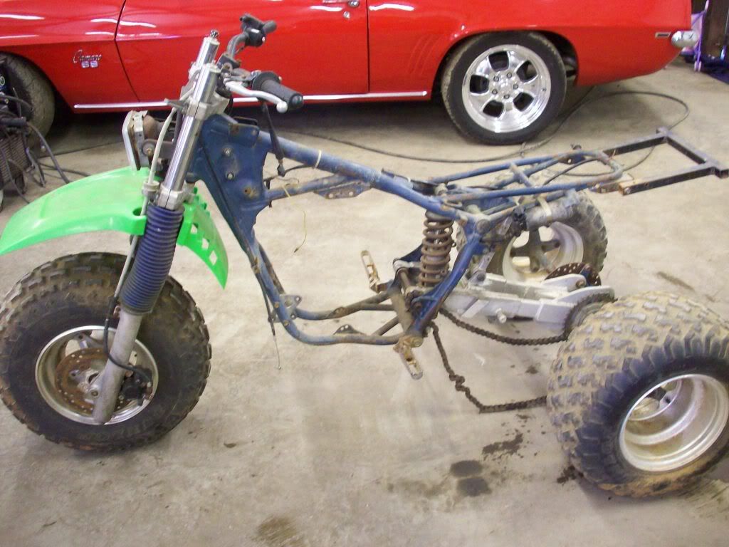

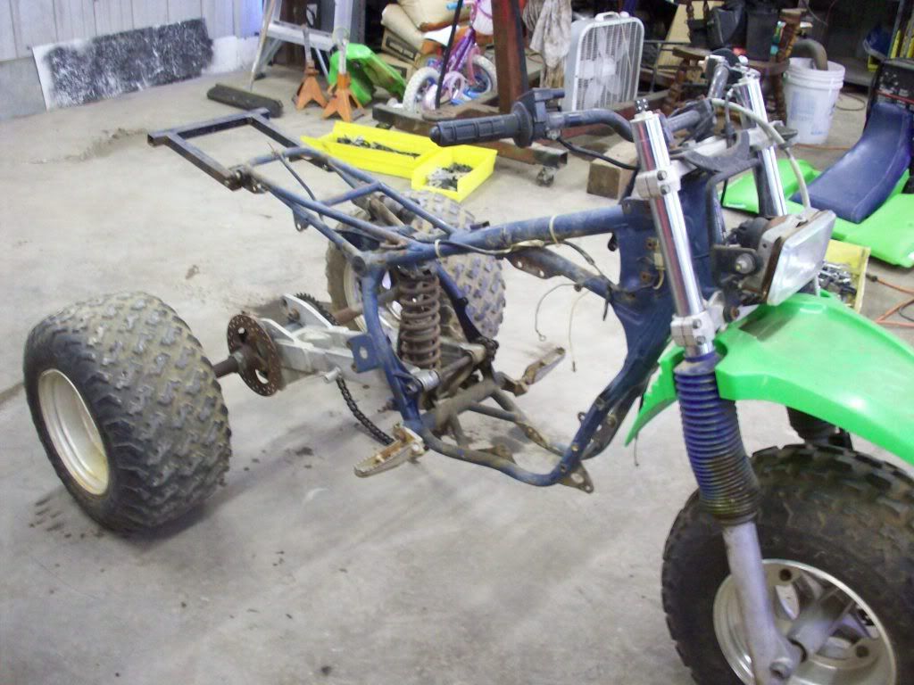

    well i picked this up and think i can have it together just in time for the OK ride
    http://www.3wheeler.org/vb/showthread.php?t=33316
    the bad parts are
    the engine is roasted and split by the previous owner
    top end is missing in action
    the tank is in bad shape
    no shrouds
    forks are leaking
    electrical is missing
    tires are rotted
    the good
    the fenders are ok '
    the seat is fair for a rider
    it has a headlight frame
    goals are
    no fresh paint
    no good looks
    complete rebuild on the engine
    new chain
    kx250 ignition
    so here are the pics
    if you have a spare engine let me know, i need it :doh:
