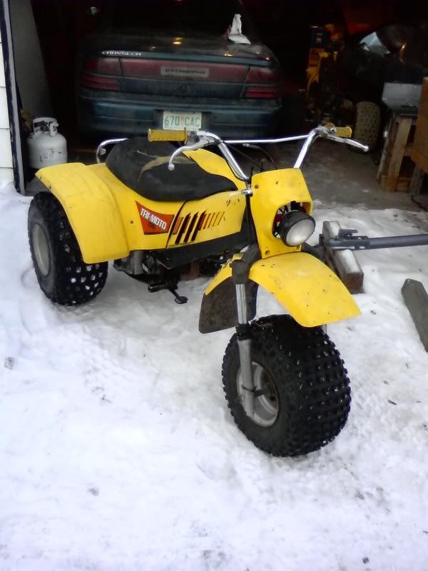

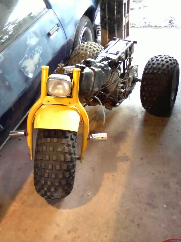

    And here are some pics, I'm assuming the guy before me swapped the skins and front end, because the one that says 175 is actually a 125.
    The 175 right now is in parts, I just put the wheels on (gonna bolt up the front end tomorrow as long as all the bearings are there)
    The 125 we were going to try to start today, but the tires are low on air, and it was too cold for our old compressor to start up

    haha i'm liking the pegs welded onto the forks for cruisin
