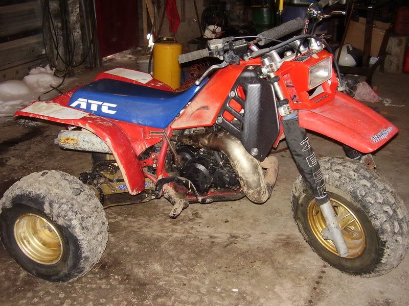

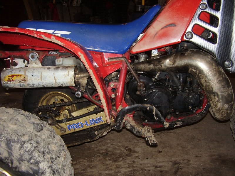

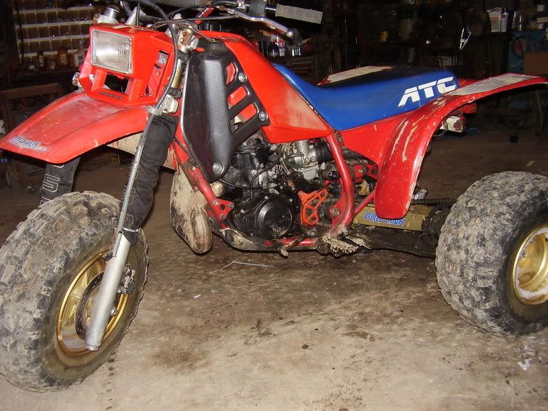

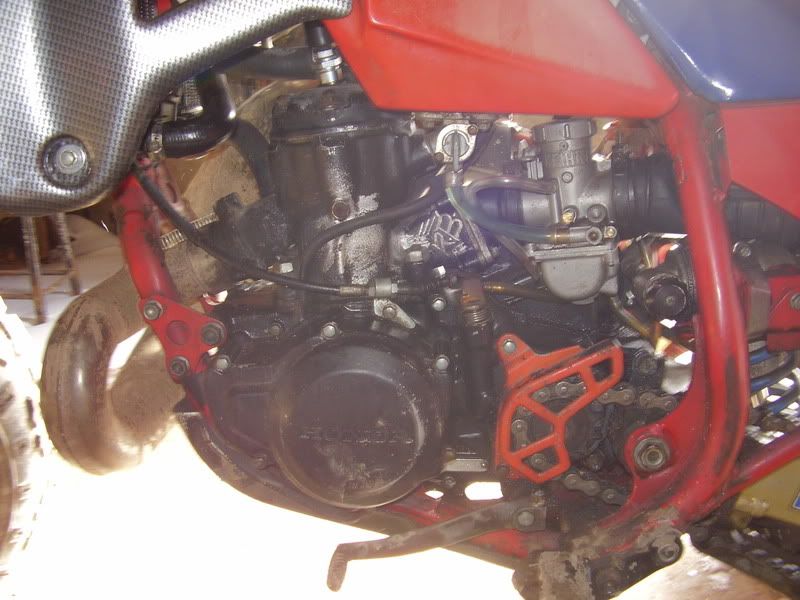

    Hey guys, Just picked this up from Jim aka Xsystem
    Its got a RB ported motor
    FMF pipe and can
    CF shrouds
    New plastics on the back
    Some OLD school Dean Sundahl bend answer bars
    Plans- Swap the progressive front end from my race bike to it when I replace with inverts on my racer
    Add wheel spacers
    Wet sand the tank and buy new front fender
    6 pack rack thanks Chris!
    Custom seat cover from the highly sought after moshs
    Ride it till shes dead!
    Pics-

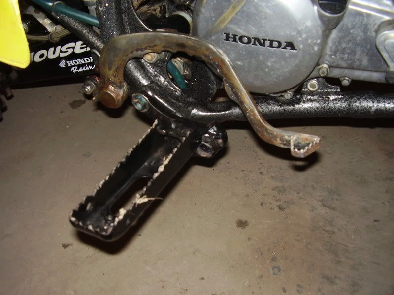

    Now for the 450r pegs. I bought these off ebay (thanks Rick and Dawn!)
    All I did was take a stock set of pegs I had layin around and take the peg off. Use the hack saw and cut off the remaining mounting plate. Take the grinder and clean it all up then weld the 450r pegs to it. There is a little trimmin on the 450r pegs to allow enough surface to weld to.
    I am now within a 1/4 inch of the stock pegs and they feel MUCH better!

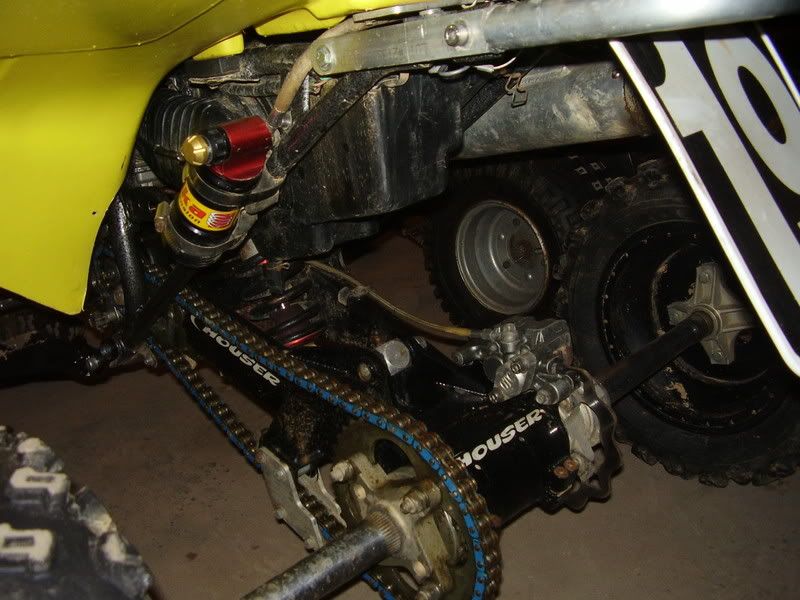

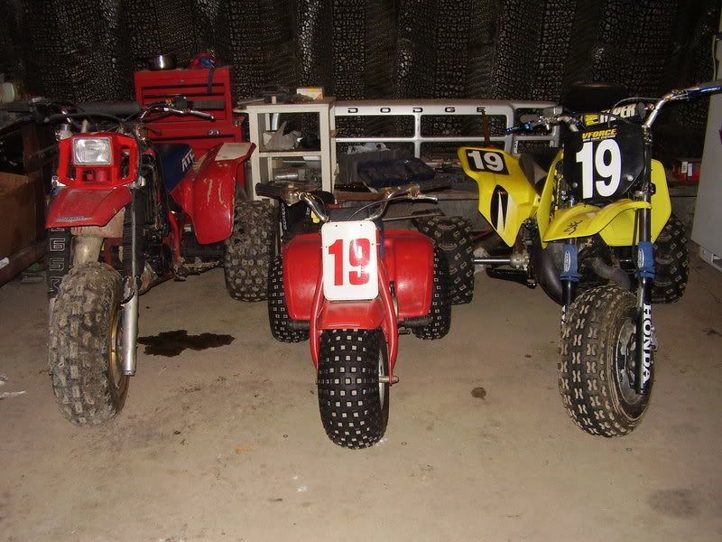

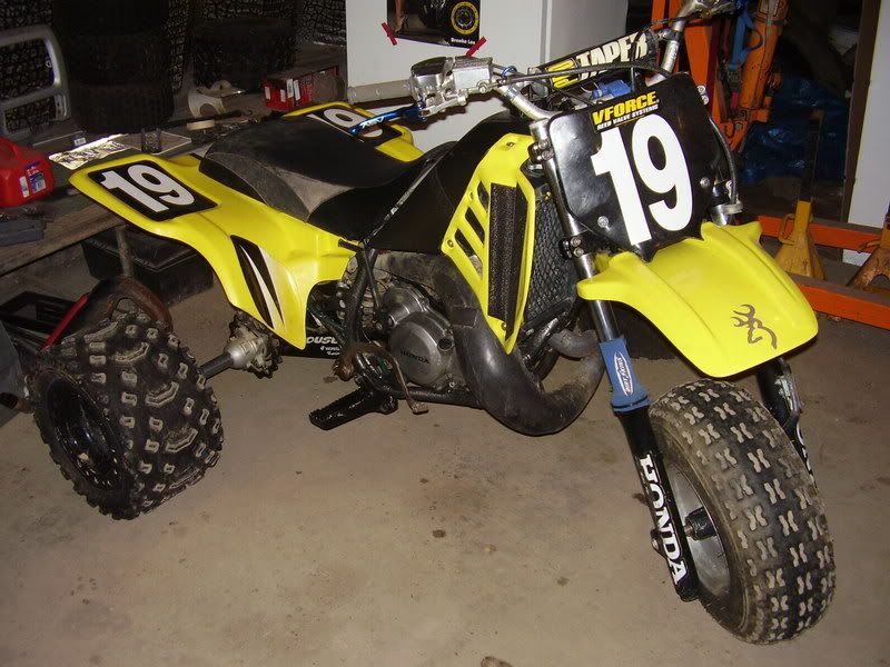

    And lastly, heres some pics of my race trike and the lil gaffer of a 70
    Quick update on the racer-
    Inverts and elka steering stab coming SOON along with fast flexx bars
    What its got
    265 Duncan PV motor
    39 mil A/S
    +4 LSR axle
    Elka elite shock
    -1 Houser swinger
    Rare Yellow Low pro fenders
    Custom seat

    i'm diggin the yellow r

    Soooo...my tech tips on how to build those pegs finally came in handy huh, little bacon? lol

    all three look good! And the 450 pegs look good.

    The yellow bike is tits right now, i love the way it handles!
