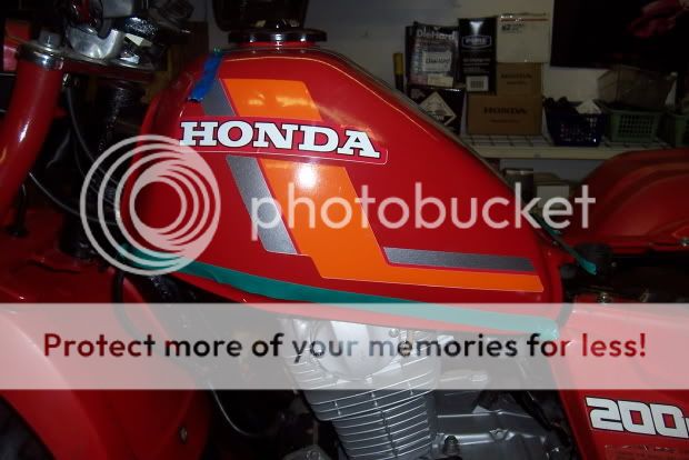

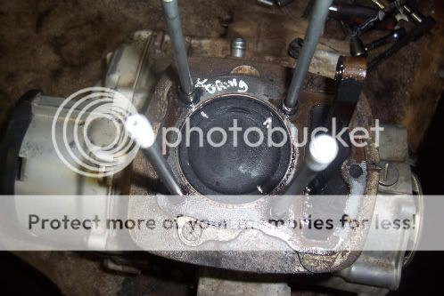

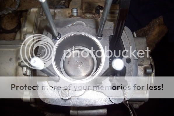

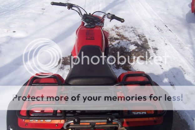

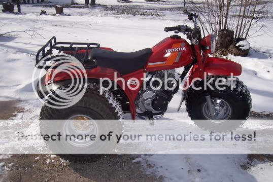

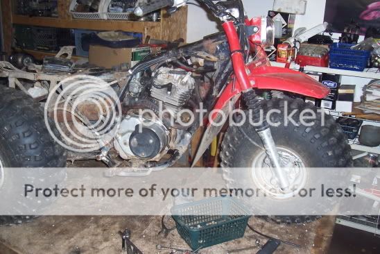

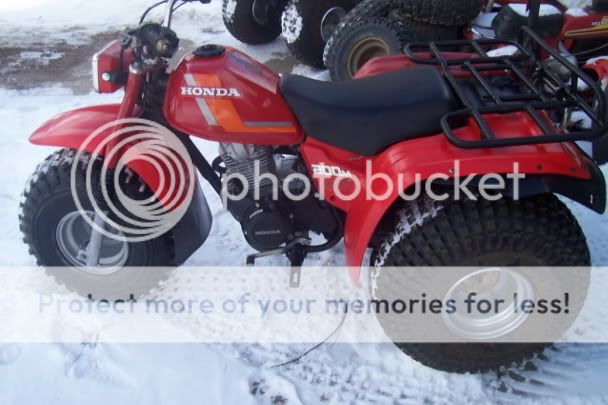

Well got another one done and in the book's.Although not one of the most popular machine's as far as Honda's go,I picked up this '84 200M a few month's back and decided it was a nice candidate for a complete restore.I've done restore's on all the 200 Big Red's but never on a 200M so this machine completed those Honda 200 model's for me restoration wise.When I picked up the old girl she had some issue's from a leaky base and head gasket ,a pretty loud ticking noise,the dawg on the recoil was not working properly so it was catching on the recoil cage on the flywheel and the clutch was fried too the point that it barely moved,just slipped.Ah' what else - oh the exhaust gasket was blown out ,carb leaked gas out the bottom,tank was dented,left rear fender was cracked,brake's were shot cable's were junk and lot's more issue's.LOL,sound's like quite the list but I felt it deserved another chance,so I started the restoration.
This one was pretty much a complete restore from the ground up,including the motor.I got the motor out and blasted it assembled and started taking it apart from there.I went with a complete top-end rebuild with a stock cam,new timing chain,piston ring's redid the head with new seal's,did a competition cut on the valve's and seat's,did a simple cross hatch on the cylinder which was still on stock bore and a few other thing's as far as the top.I also replaced the clutch and all those goodie's on the right side case and with the carb I made it easier on myself and just went with a new carb.Motorwise everything was actually in pretty good shape,it looked as though it was not maintained really good and the gasket's had been leaking for sometime with all the oil not only on the motor but all over the frame.It was a cosmetic trainwreck.Here's a couple pic's of when I first got it up on the operating table a day or so into the project,after I cleaned it off with the powerwasher.More down below:![]()
