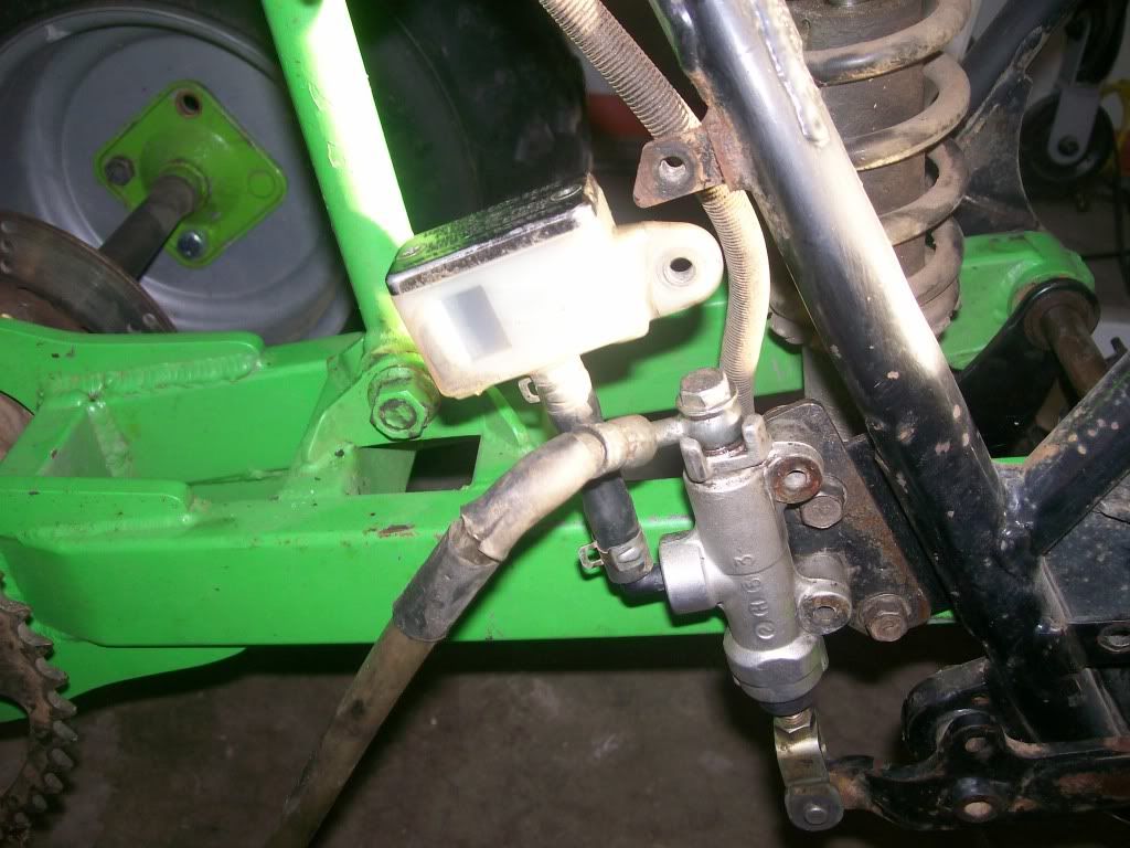

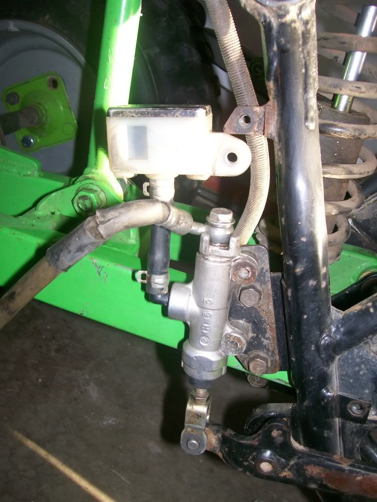

    1993 KX125 rear master cylinder is a bolt on for the 84-85 Tecate. A longer reservoir hose will need to be used for the reservoir to go in the stock position. The reservoir is smaller and rectangular which will keep your foot from hitting it while kickstarting. The stock rear brake hose will bolt up fine. Here are some pics.
    The 93 KX125 also comes with an aluminum master cylinder guard, I'm going to try to pick one of these up and see if it will fit as well. There are rebuild kits available for this master cylinder too.

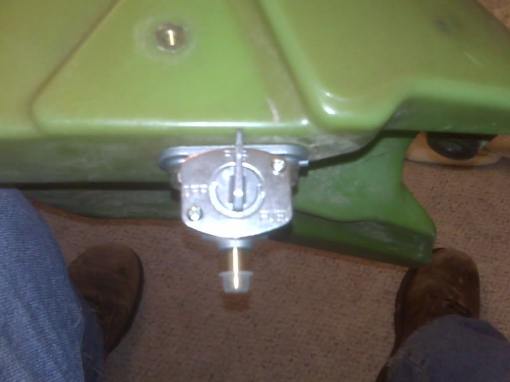

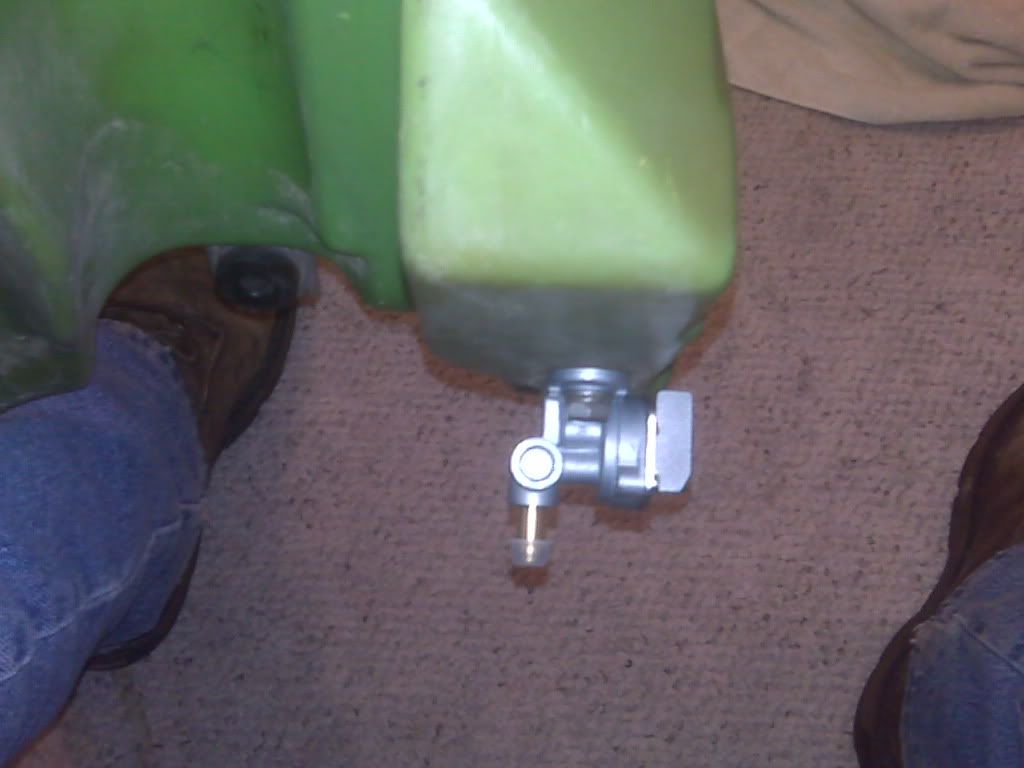

    Here is a pic, it looks to have reserve
    Quote Originally Posted by scottyms View Post
    Yamaha 2HR-24500-02-00
    petcock for a yfm400 big bear
    list price is 26 bucks, discount prices about 15 bucks
    Fits good... outlet is out the bottom... i think we have a winner!!!
    scotty
