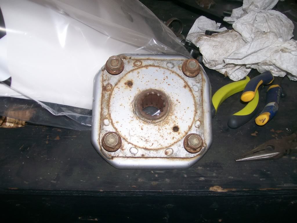

    1985 KLF185 quad rear hubs are 13 splined and have a 4/110 hub spacing. These fit on the 84-85 Tecate rear axle. The 87 KLF185 rear hubs are 4/110 as well but look to be splined for the 86-87 Tecate rear axle.

    So I just went on ebay and you are right the spines are finer on the 87 hubs .Funny thing is all these ebay seller are selling these hubs 1 by 1 ? They are not giving them away by any means either ! even more funny is the klf 185 "87" hubs they are selling for half the price as the 85 hubs . So basiacly you are looking at almost $100.00 to do this . I figured they would have those hubs for sale for like $10.00 ,I was surprised to see the prices . Can the Tecate guys ever catch a break?
