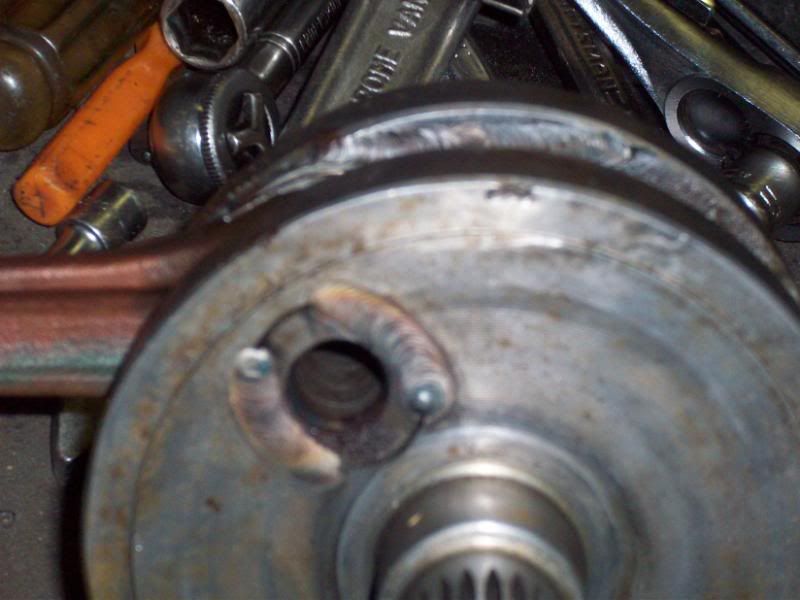

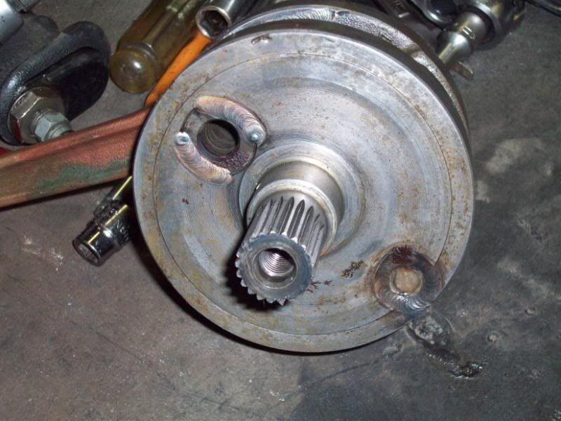

    300rman's Avatar
    Nov 2007
    toledo
    2,667
    Quote Originally Posted by 88 Turbo Coupe View Post
    I know back in the day the talent was there to full circle a crank. It was common. Maybe a lost art now in 2009.
    i have one of those modified stock cranks, made to a full-circle.
    look closely, you can see the welds.
