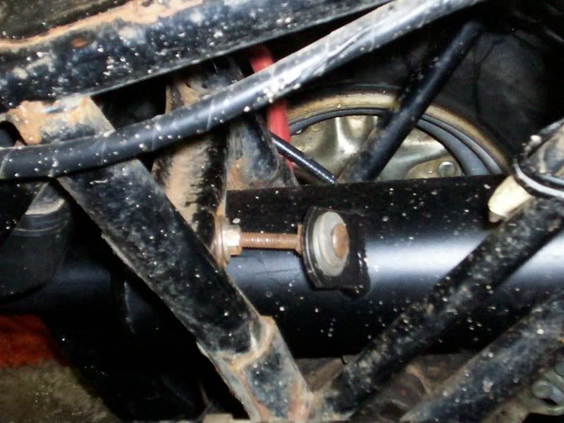

    Hey got the picture, shows you exactly how i did it, and yes you have to rejet, its very easy to do, just take off the carb, and the carb bowl, you will see the main jet the needle goes down, unscrew it and thats what you have to replace, urs is prolly a stock 98 to, i would just get some sizes, maybe a 100 102 and a 104, i got those sizes and the 100 worked perfect for me, doens't bog down, flood or anything. the spark plug color is the right color to thats how i know its running right, a tanish brown, to a grey.

    Only thing else I needed was the exhaust gasket, you can get it at www.bikebandit.com or even ebay or denniskirk. umm when i slid the silencer into the header pipe i put a exhaust silicone orange sealent in there so it was sealed good, worked out great, i was also tihnking, i could have just trimmed the header pipe down a little bit, a couple inches, so then the silencer would have bolted right to the frame, who knows maybe if i feel like screwin around with it i will but i don't want to mess it up
