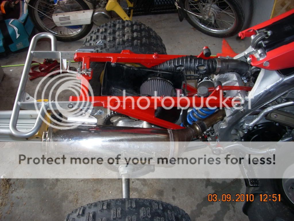

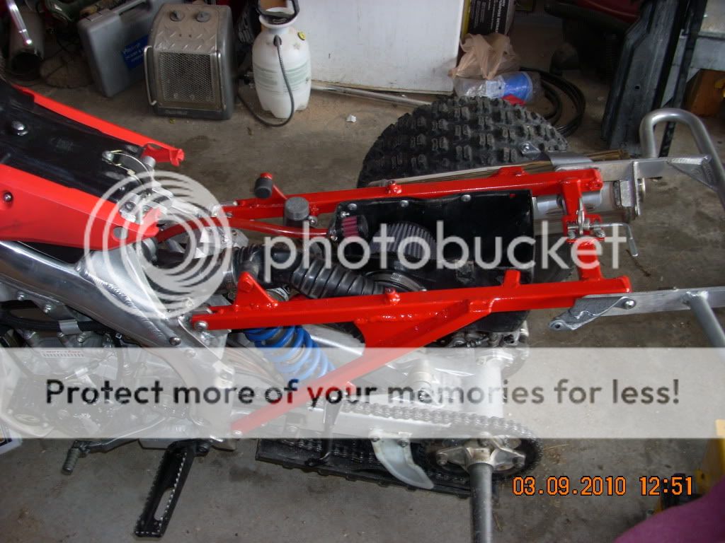

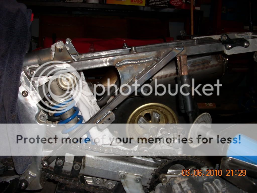

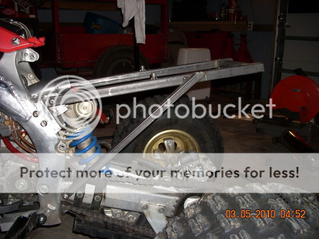

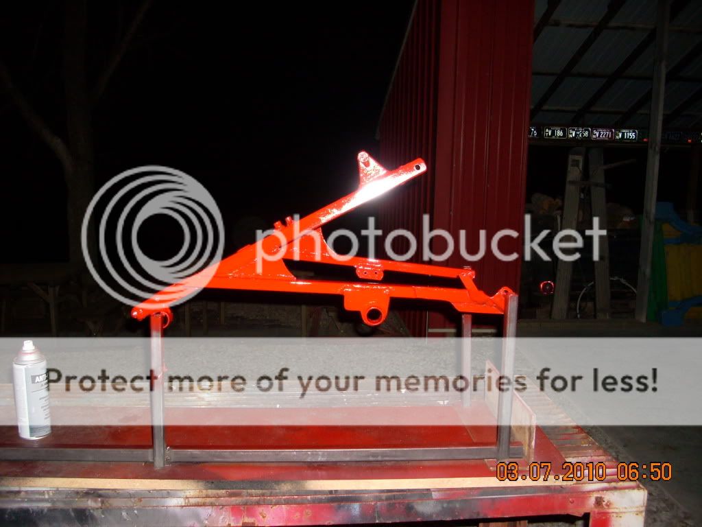

    I could have used an aftermarket trx subframe, but they are very very pricey, around $600. I would have liked to have used chromoly, but I no longer have easy access to a tig like I did when I originally built this, so that makes it complicating. I am not worried about my tig skills, but the lack of a machine makes it hard.
    I ended up using 1" 14ga mild steel square tubing for my upper tubes with 3/4" on the lowers. It did take significantly longer than I had planned, but it turned out great and I am very happy. Also am now using an 85/86 ATC250R airbox and intake tube that worked out great. Headed to Little Sahara Waynoka Oklahoma this weekend, so it will get torture tested.

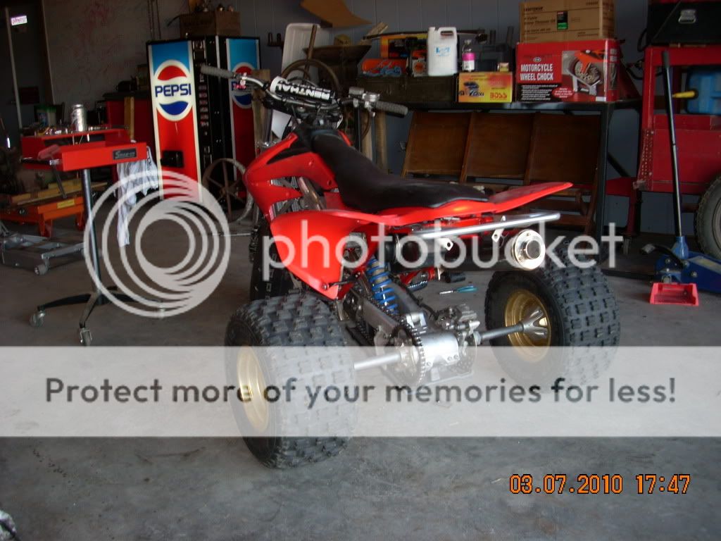

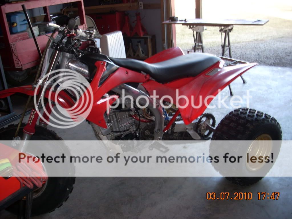

    Some pictures of it back together.....
    I did not change the angle of the seat, I love how low my seat height is and how low that makes my center of gravity. When I ride the TRX450R's I feel like its gonna tip over. I matched my seat height to the same as the 85/86 atc250r and it works out perfect. This is however what lead me to have the long seat that I have, but thats okay sometimes I used the whole seat depending on how agressive I am riding.

    I really appreciate how you have kept a low seat height, and I like the idea of the long seat, its just a little out aesthetically speaking. Witch detracts from, what is, an awesome build.
    But given the height of the old shock mount I suppose there is very little you can do about it.
    But I don't want to make it sound like I'm all negative, Excellent build you have there.

    No offence taken. The only other way that I think I would have been able to achieve the low seat height would have been to make my own tank, like jason did, I just don't have the skills or tools necessary to do something that in depth....yet. I agree that it does somewhat distract from the overall cleanly ness of the bike, but I wanted it to be more comfortable and easy switch over from my R rather than just be all about looks. Might try and make my own seat pan or modify this one again sometime, just no time right now. Some day I will build another and use what I have learned from this build to make the next one better. Thanks for the comments and complements.
